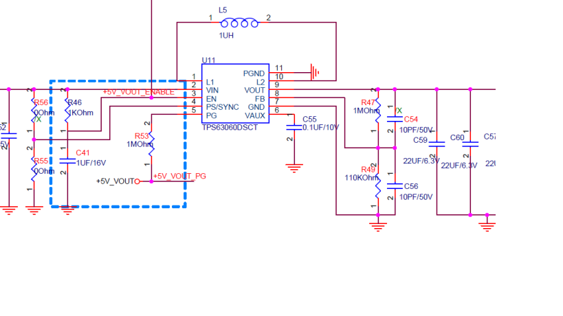

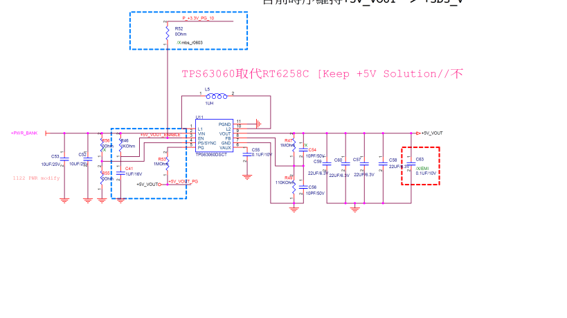

               Please refer to attached again. It should no setting password to open it. Per schematics, modification is below.
    R49 110Kohm change to 120Kohm,R55 0ohm move to R56 PWM mode

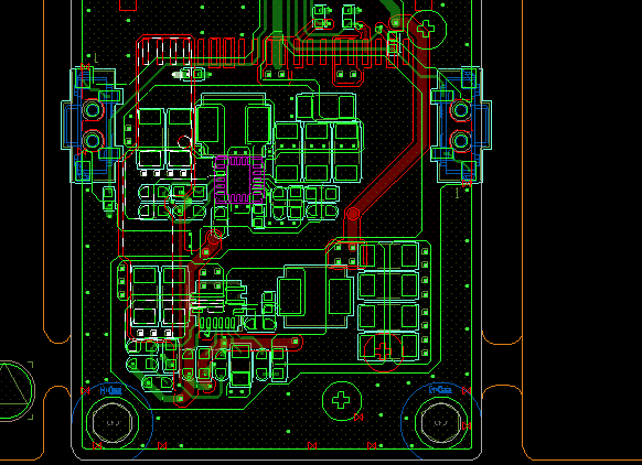

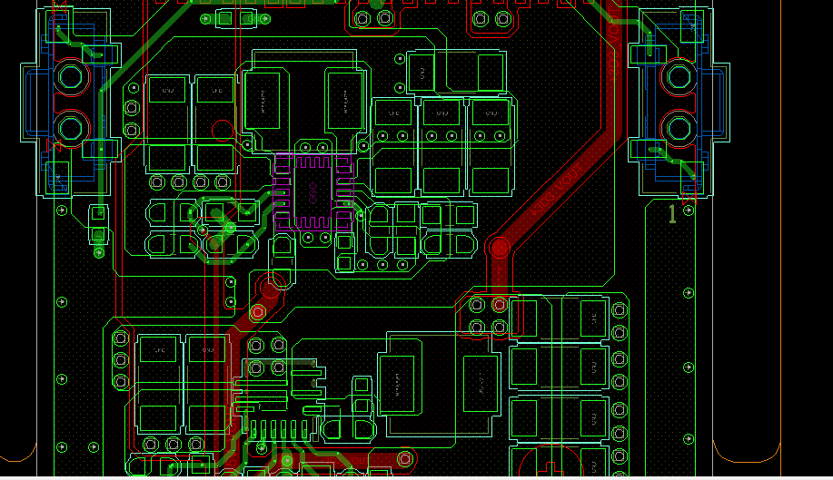

  • Hello Minqiu
           Screen are below. Thank you.

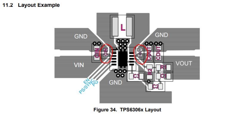

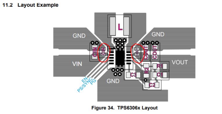

  • Hi Patrick:
    Thanks for your supplement.
    According to your layout, the package of the Cout, Cin is large. It's recommended to add a small size and smaller value cap close to the IC to reduce the parasitic parameter.Below is the example showed in datasheet.
    And the C56 is recommended for PFM mode. If you choose disable PFM, you don't need it.

  • Hi Patrick:
    It's better to measure the waveform of L1, L2, Vout, to check the switching noise. ( We have heard a lot of customer damage their circuit with improper layout.)
    For the C56, as datasheet mentioned, "Place a small capacitor (10 pF) in parallel with Rdown when using the power save mode and the adjustable version, to provide filtering and improve the efficiency at light load." If without this for PFM, there will be more noise and less efficiency.         Which mode do you want? I'm little confused.....
    Besides, I forgot to check with the inductance. May you share the part number or datasheet of the inductance with me? If there is no enough current capability of inductance, it also will damage the converter when saturated.

  • Hi Patrick:
    The C56 will influence to the controller loop. But generally speaking, for such value it won't influence too much.
