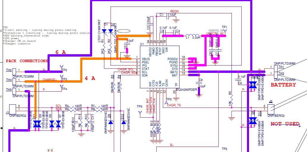

BQ24296: Charger IC /Inductor gets heated up - Please review my schematic
Part Number: BQ24296
Have  working BMS prototype board  using BQ24296  Battery Charger, BQ27542 Fuel Gauge, BQ29701 protection IC. Functionally all the ICs are working fine.
Charger IC/Inductor is getting heated up when current limit is increased to default   max ( Ilimit R = 120 ohm), with charging current at its default value of 2A.  On a few boards charging IC failed.
Part of the schematic is below. Please review and suggest what could be wrong.  Inductor used is  IHLP2020BZER2R2M01 / Vishay make
Also, please review the ground path. All ICs ground are connected to  B- now. Is it OK ?
Would like to send entire schematic for review in a private message.
Thanks in advance for help.
