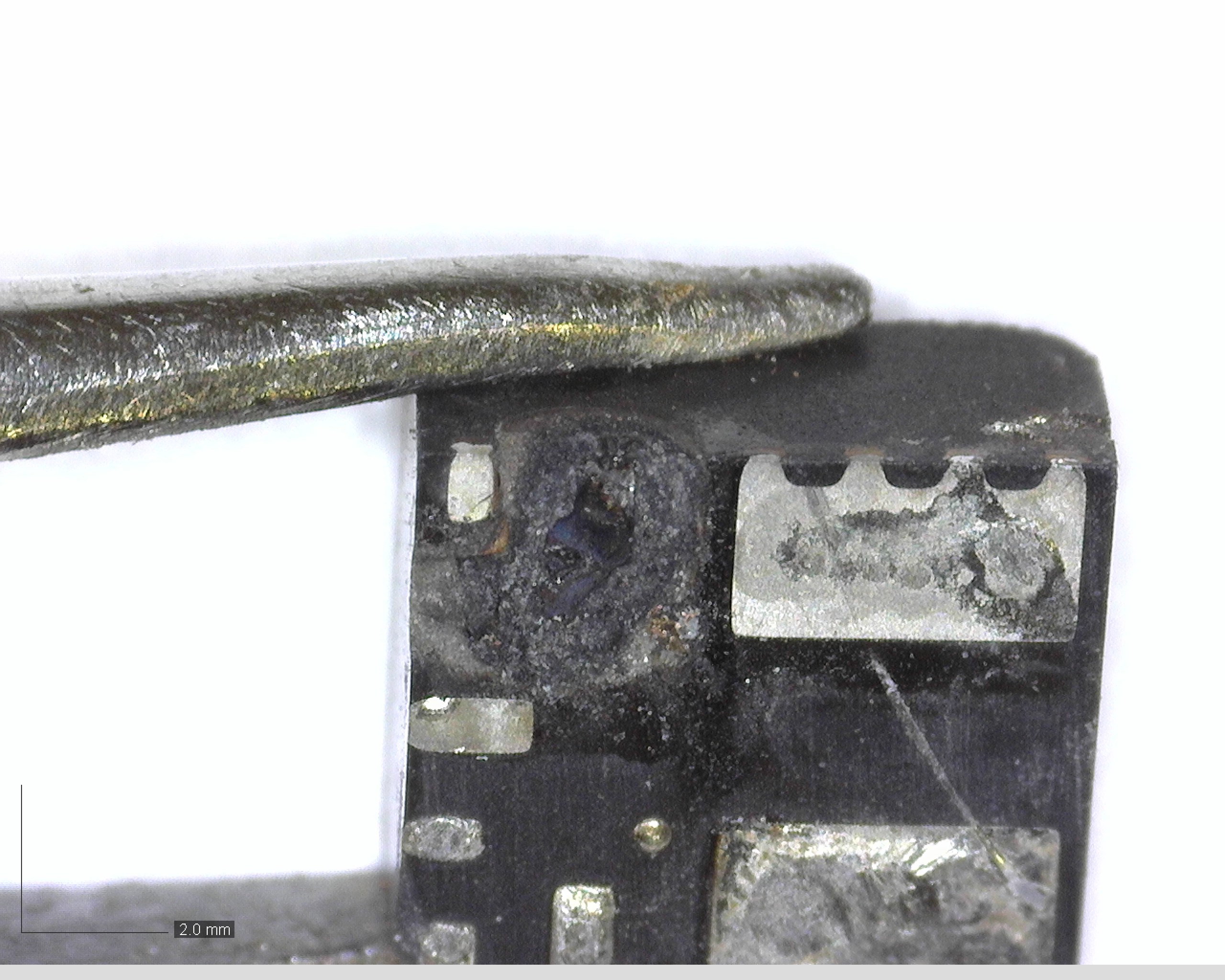

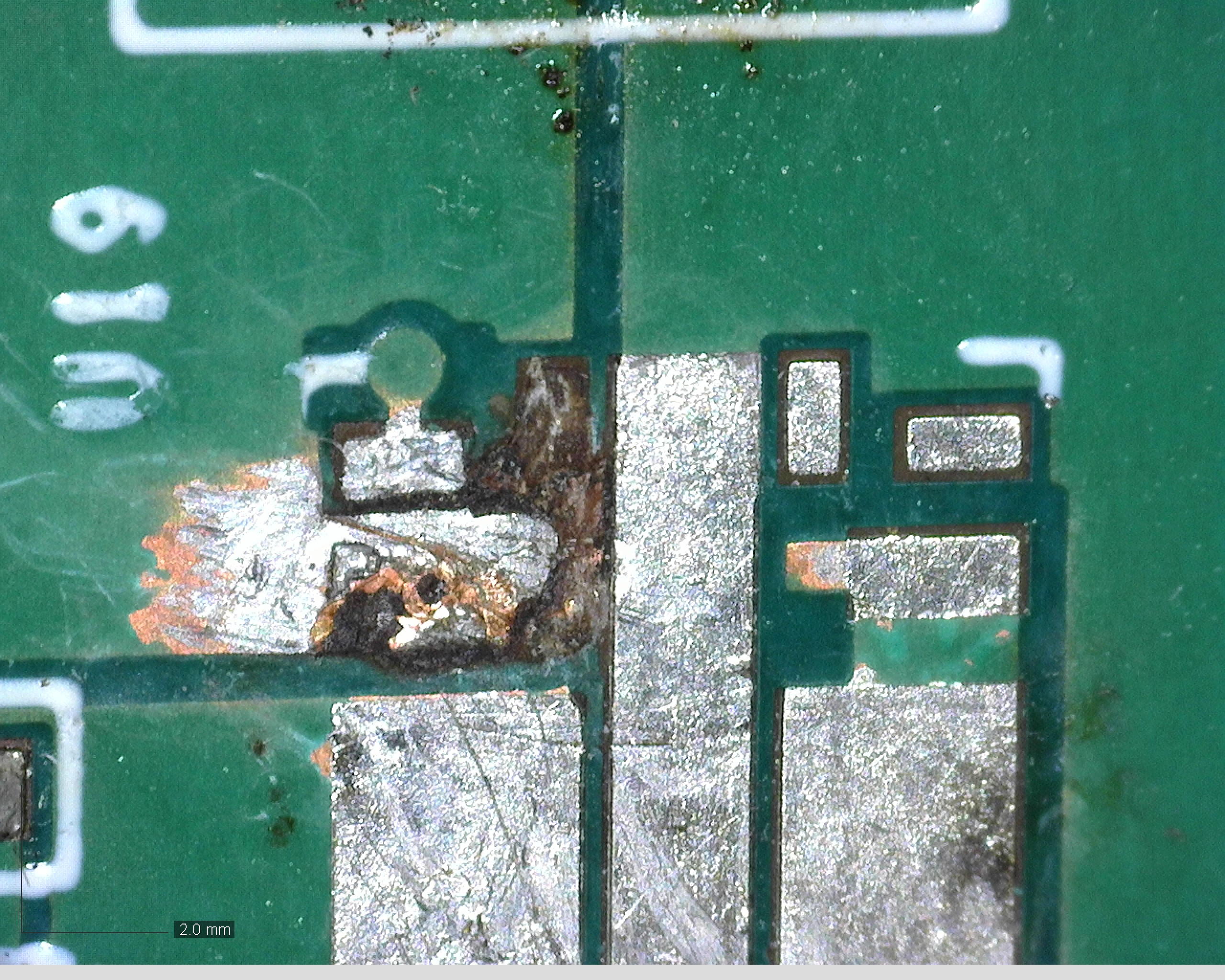

We have a custom PCB with a TPSM84209RKHR as the initial 24v to 6v power supply.  There are 7 other supplies that take the 6v and supply other voltages.  3.3v, 1.8v, 1.5v, 1.2v and 1.0v are buck regulators,  a 3.3v LDO and a 0.75v DDR3 termination supply.  We have 2 boards where the TPSM84209 has burned out.  One we have investigated, the other is still off site with an engineer that is developing code for the board.  The one we looked at get's so hot that the Vin pin gets welded to the copper pad on the PCB.  It also carbonizes the PCB between the Vin pin and the ground layer just below.  When the TPSM84209 and the other few components that are part of the 24v circuit are removed (input filter capacitors etc), there is still about 330ohms from the Vin pin to ground.  If you look at the chip under a microscope, it looks like someone took a tiny blow torch around the Vin pin.
Both times the IC burned out were immediately after the engineer powered the board up.  He had been working with the board for hours and had only made minor changes to the code in the FPGA between power off and on.  The same code ran fine on another board.  When we remove the burnt TPSM84209 and supply 6v directly to the rest of the board, the total current draw at 6v is only 0.5A and the board functions normally.  So it doesn't seem like we are drawing too much current.  Even if we were possibly drawing too much at power on, the IC has over current and over temperature protection which I think would protect it.  This seems to be something happening inside the IC or possibly a PCB issue.  I have verified our schematic matches the Webench schematic.

    As a side note, from your PCB image, I see that you have exposed copper, i.e. no solder mask, for ground down the middle under the device. The datasheet (p.30) shows the example layout with top metal underneath the middle of the device, but exposed copper just under the GND pad itself. In your layout, I am wondering if perhaps VIN is getting shorted to GND underneath the IC, though that would not explain how a board that is initially working would suddenly burn out.

    The footprint I used I downloaded from a site like SnapEDA.  I didn't catch the exposed ground pad you pointed out until after we sent the gerbers off to manufacture a rev B of this board, this is rev A.  There didn't seem to be solder bridges when we removed the burnt regulator, but there could have been.  But like you said, that wouldn't explain why the board worked, then suddenly burnt the supply IC.
    I do have a question about the 2 exposed metal circles on the bottom of the chip.  The datasheet shows it as a keepout area around these.  I have the keepout in the footprint, but if you look there is a small finger that I missed in the area of one of those circles.  If that shorted, could it cause this kind of catastrophic failure?  I cleaned up those areas in rev B thinking it could be a problem.  Too bad I missed covering the ground pad.

    The exposed metal circles are connected to the switch node, so a contact or short to other signals could cause damage.

    Our current theory is this, I'd like your input on it.  The ground pin down the middle of the footprint was not covered by soldermask, my mistake.  We think it's possible that slight inaccuracies in placing the ICs on the board, and then the solder reflowed, that the exposed pins on the bottom of the IC settled very close to the ground pad.  You mentioned that those pins were connected internally to the switch node.  We think that if they were close enough to the ground pin, without touching, that when the IC powers up a small arc could occur, possibly from an inductive spike in the internal inductor or possiblly through some impurities trapped under the IC.  If one of those pins were shorted to ground, it could cause the destruction we have seen here.
    We were able to catch the board fabricator in time to change the footprint so that the soldermask is correct with the datasheet on our rev B.  So we are hoping that will solve the problem.
