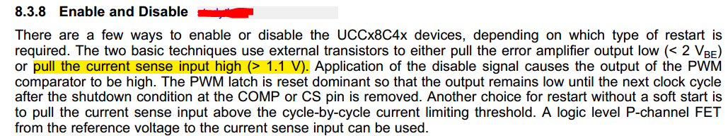

  • Hi Elisha,
    In the datasheet in the section 8.3.1.1 is stated: “…… . The error amplifier is internally current-limited, so that one can command zero duty cycle by externally forcing COMP to GND.”. However no value for the current limit is specified at datasheet. And I expect larger current with VCOMP “shorted” to ground.
    If the customer is worried for excessive power consumption then the datasheet also suggest alternative Enable/Disable methodology in the section 8.3.8. I highlighted one more method in yellow in the snapshot below. I think that pulling the CS pin high could have lower power consumption.
