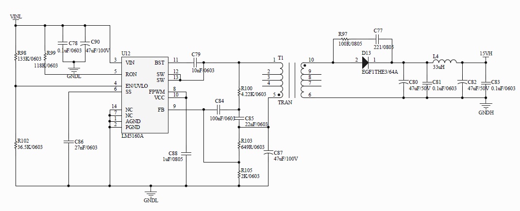

LM5160-Q1 Isolated DC/DC:
Input : 6V~60V
Out put: 15V /500mA
Trans: 1:3
SCH as below:
Q1:  NO load, output normal is DC15V . When loading >100mA, Output abnormal is 0V. SCH   SCH is correct or not? If have some design referrence messages? Can other solutions be recommended?
Q2:  What is the max current of LM5160-Q1 @ DC15V(Input 6~60V)?
    a 1:3 turns ratio is not advised for FlyBuck topology.  Recommend an inverting Buck boost on the primary, setting Vout primary to -15V out and use a 1:1 turns ratio to get 15V out at 0.5A.  With a 6V input voltage, you should be able to obtain 0.5A out.  Please see attached spreadsheet for basic design approach.  Please refer to the "Designs" tab for the inputs matching your requirements and refer to the "Fly-buck-boost" tab for the design approach.

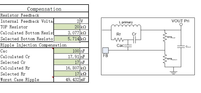

    Q2: Compensation setting as below, RFB(bottom) calculated is 3.077KΩ, why selected is 5.714 KΩ?
           If selected other value? RFB(top) =133K and RFB(bot)=20KΩ.
    Q3: Ripple injection compensation: Cac ,Cr ,Rr  ,Is there a detailed calculation formula? How to understand worst case ripple 50mV?

    Set the feedback resistors to the values you mentioned above.  This is OK.
    Answer 3.
    Set Cr and Rr at Vin min, this is worse case as per Equation 8 in the datasheet.  You can reduce the worse case ripple voltage to 25mV.

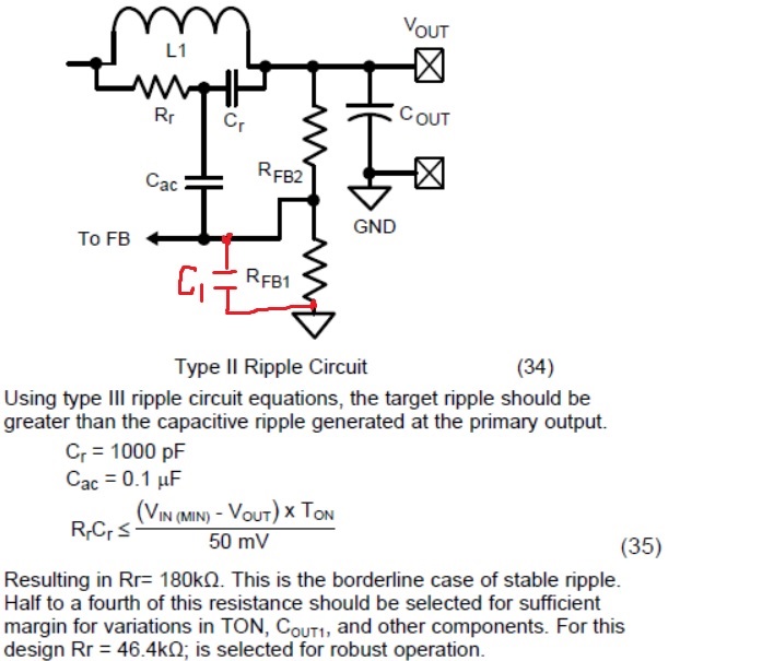

           I plan to design Cr=1nF , Rr=47KΩ, Cac=0.1uF, This setting may meet reference value,Is this OK?
           I try to debug and setting Cr=22nF , Rr=4.7KΩ, Cac=0.1uF ,Vout has no difference. Are there relevant waveform for reference(Cac both end)?
           RFB1 add C1, VFB waveform get better ,whether may setting as this?

    If you follow the procedure posted above for setting the ripple voltage at Vin, you should have adequate ripple at the Feedback node.  this can be confirmed by measuring the Ripple voltage on the feedback node, which is Feedback side of Cac.
    If you find that adding C1 across the bottom feedback resistor helps this indicates you have a noise/layout issue.  But I would make sure the design is right by following the recommendations in my answers above.
    For the layout recommendations, please follow closely the advice given in the Datasheet as well as the layout in the EVM particularly with respects to the components around the device.  Again, I do not expect things to work well if you are using a 1:3 turns ratio, this not not recommended irrespective of the layout being ideal...

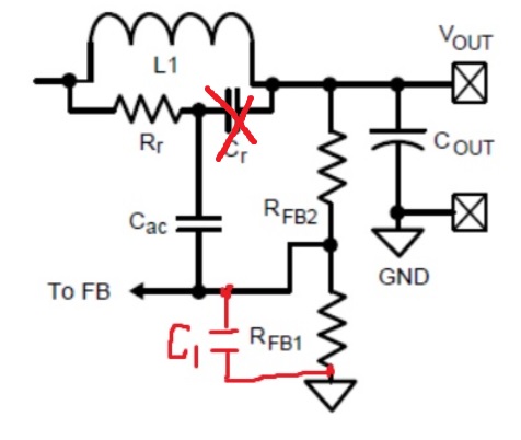

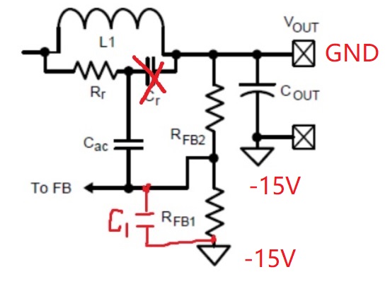

          Hi,I'm sorry to trouble you again. I want to ask new question about COT setting.
          Q1: Ripple injection on FB Range: Wether it is 25mV ~50mV?  The max value?
          Q2:Aaccording to Reference setting,Vout value range is 16.5V~13.5V @ 0~200mA .
                But according to figure as below,Vout value range is very good,15.1V~14.8V @0~200mA. That Setting is not COT.
                Wether has any questions? Do you have any suggest?

    The ripple injection voltage ideally should be set between 25 and 50mV.
    As mentioned previously, I do not recommend the configuration you show in the figure posted.  Please follow the traditional configuration of Rr, Cr and Cac.  Details of how to design with these values are given in the datasheet.  If you have any further questions about designing Type III configuration please feel free to open new thread and discuss.
