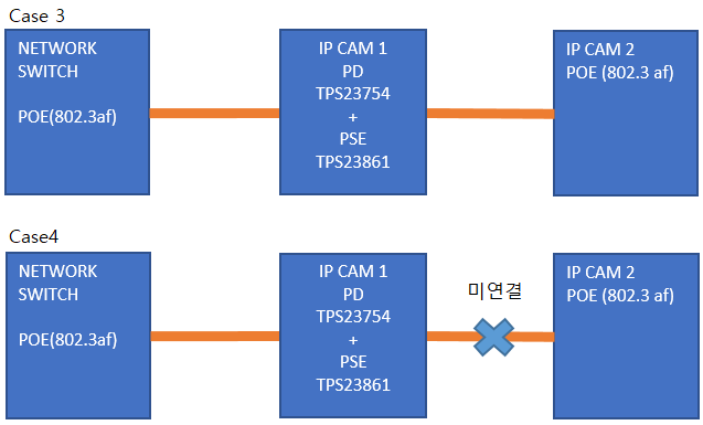

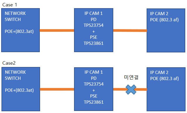

We would like to know whether the following configuration cases are applicable.
* IPCAM1 actual power consumption within 802.3af
1. Is the recommendation to fix the IPCAM1 PD TPS23754 with POE + (802.3at) with or without IPCAM2 connection?
   -> IP Can IPCAM1 PD automatically change POE class according to IPCAM2 connection (CASE1 / 2)?
2. Is there any way for IP CAM1 PD to recognize POE specification of NETWORK SWITCH (PSE) to IPCAM2 OFF when installing CASE 3 below?
3. Is there any problem in IPCAM1 operation when installing CASE 4 below? (IPCAM1 PD setting is POE + (802.3at))
