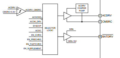

1. as share image1, BQ24773 of CMSRC+5.9V meaning ..? what is required voltage on 5 volts input adapter across the CMSRC ..?

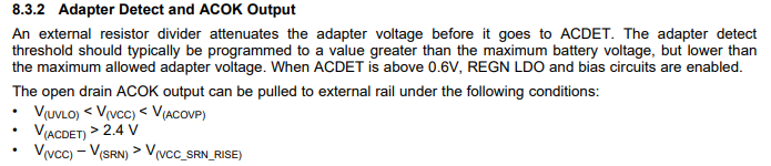

3.as share image2, ACDET require more than 2.4 V ..?

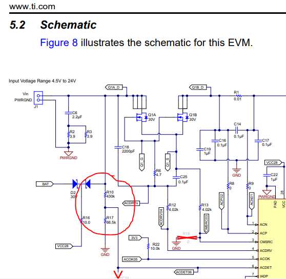

                 Also check ACDET > 2.4 but there is no change in ACDRV Voltage
    we replace R1=390K & R2=470K for ACDET= 2.7V
    If ACDET is rquired to set >2.4 volts as per the datasheet
    In the TI BQ24773 Evaluation reference design there is ACDET set to 0.65V...??

    1. That is the reference voltage for the ACDRV voltage. ACDRV is meant to be 5.9-6V above the CMSRC voltage.
    2. The charge pump is referenced to the CMSRC voltage. You need to meet the ACOK conditions in order for the charge pump to be active.
    3. Yes, ACDET requires more than 2.4V to operate the converter. It must be >0.6V in order to have the IC active.
