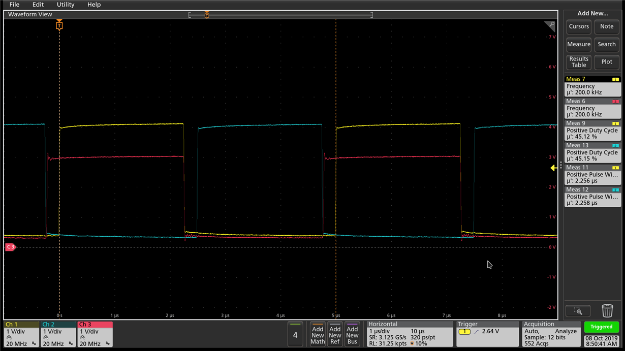

  • Referencing this post https://e2e.ti.com/support/power-management/f/196/t/298579?unable-to-get-UCD3138-external-sync-working we were able to get external sync partially working. DPWM0 is synced to the external signal although the phase delay changes with frequency. We are testing with the J2 jumpers removed so we can examine the gate signals without cycling the fets. With the external signal frequency = hard coded frequency, the DPWMs behave as expected with duty cycle = 45%. (Ch1: DPWM0A, Ch2: DPWM1A, Ch3: External Sync Signal)
    If our sync frequency increases, the rising edge of DPWM1 remains at 1/2 the hard coded period, but the pulse width reduces as DPWM0's pulse width remains the same.
    If our sync frequency goes lower than the hard coded frequency, DPWM1's pulse width remains the same while DPWM0 pulse width increases and pushes the rising edge of DPWM1 >1/2 hard coded period.
    Could you please review our code to see if we are on the right track?

    Period is still based on the hard coded value so we may need to implement some timing adjustments as outlined in the document you attached in your initial response. We are just unsure if there is a better configuration which would avoid this issue altogether. Thank you for your help thus far.

  • Unfortunately there is no hardware configuration that takes care of all cases.
    What is your topology? What your Event4 is set to?
    Some firmware help may be required.
  • It is a hard switching full bridge. Currently there are only minimal mods to the stock EVM firmware. DPWM0 and DPWM1 use output B for synchronous rectification. I am not sure how the stock firmware handles EV4 just yet. I will need to look into that more.
    I am also tying to figure out how to setup timer capture...
    Thank you for your continual help.
  • According to the best of my knowledge the HSFB EVM code does not set the Even4 to zero.
    Therefore the chance of pulse extension when SYNC is used needs to be considered.

  • I am now unsure If it is working as expected. Even if standard interrupt was occurring every 1.15ms i would expect t24_latched_diff to have an inversely proportional relationship with the frequency of my external sync signal. I tried adjusting this sync signal in intervals of 1kHz, 100Hz and 10Hz. Regardless, t24_latched_diff bounces around near 17,955 +/- 5 with some outliers. I expect some drift based on internal frequency but something is not right here.
  • Setting Event4 to zero is an easier task than making TCAP work. And it might be all you need.
    If the EVM code Event4 is set before the end of period, and the dead time is equal to ((Period -EV4)+ Ev1)
    If you set EV4=0, then the dead time is equal to (Ev1 -Ev4 =Ev1)
    So if you set EV4 to zero, you need to set EV1 to a larger value (Add the original (Period -EV4) value to EV1).
    The reason for setting EV4 to zero is that it will prevent pulse extension.
    This is due to the fact that after any reset of the DPWM counter, the value of B output will be forced to go low.
    Hope this makes sense.
  • For initial testing i commented out the original Event 4 lines of code and set it to 0. I then added pmbus_dcdc_config[0].deadtime_X to Event 1 in each module. Regardless, Event 2 is calculated from a period that does not vary with the external sync signal. That is why i thought i needed compensation. With EV4 = 0 it appears to occur sooner when viewing on an oscilloscope, leaving more deadtime between syncFET signals.
    void configure_dpwm_timing(void)
      	Dpwm0Regs.DPWMEV2.bit.EVENT2 = (pmbus_dcdc_config[0].period >> 1)
      	                               - pmbus_dcdc_config[0].dead_time_2;
        Dpwm0Regs.DPWMEV4.bit.EVENT4 = (pmbus_dcdc_config[0].period
                                       - pmbus_dcdc_config[0].dead_time_1) + 540;
      	if(Dpwm0Regs.DPWMEV4.bit.EVENT4 > pmbus_dcdc_config[0].period )
      		Dpwm0Regs.DPWMEV4.bit.EVENT4 = Dpwm0Regs.DPWMEV4.bit.EVENT4 - pmbus_dcdc_config[0].period;
      	else
      		Dpwm0Regs.DPWMEV4.bit.EVENT4 = Dpwm0Regs.DPWMEV4.bit.EVENT4;
      	Dpwm0Regs.DPWMEV4.bit.EVENT4 = 0;					// SRS 10/15/19 to prevent pulse extension
      	Dpwm1Regs.DPWMEV2.bit.EVENT2 = (pmbus_dcdc_config[0].period >> 1)
      	                               - pmbus_dcdc_config[0].dead_time_4;
        Dpwm1Regs.DPWMEV4.bit.EVENT4 = (pmbus_dcdc_config[0].period
                                       - pmbus_dcdc_config[0].dead_time_3) + 540;
      	if(Dpwm1Regs.DPWMEV4.bit.EVENT4 > pmbus_dcdc_config[0].period )
      		Dpwm1Regs.DPWMEV4.bit.EVENT4 = Dpwm1Regs.DPWMEV4.bit.EVENT4 - pmbus_dcdc_config[0].period;
      	else
      		Dpwm1Regs.DPWMEV4.bit.EVENT4 = Dpwm1Regs.DPWMEV4.bit.EVENT4;
      	Dpwm1Regs.DPWMEV4.bit.EVENT4 = 0;					// SRS 10/15/19 to prevent pulse extension
  • Sorry for updating this post with related issues. It has grown substantially. DPWM0 is currently synchronized with my external signal which was the main purpose of the original post. Thank you for your help. I do have outstanding issues with TCAP, but I will start a new post for clarity.
