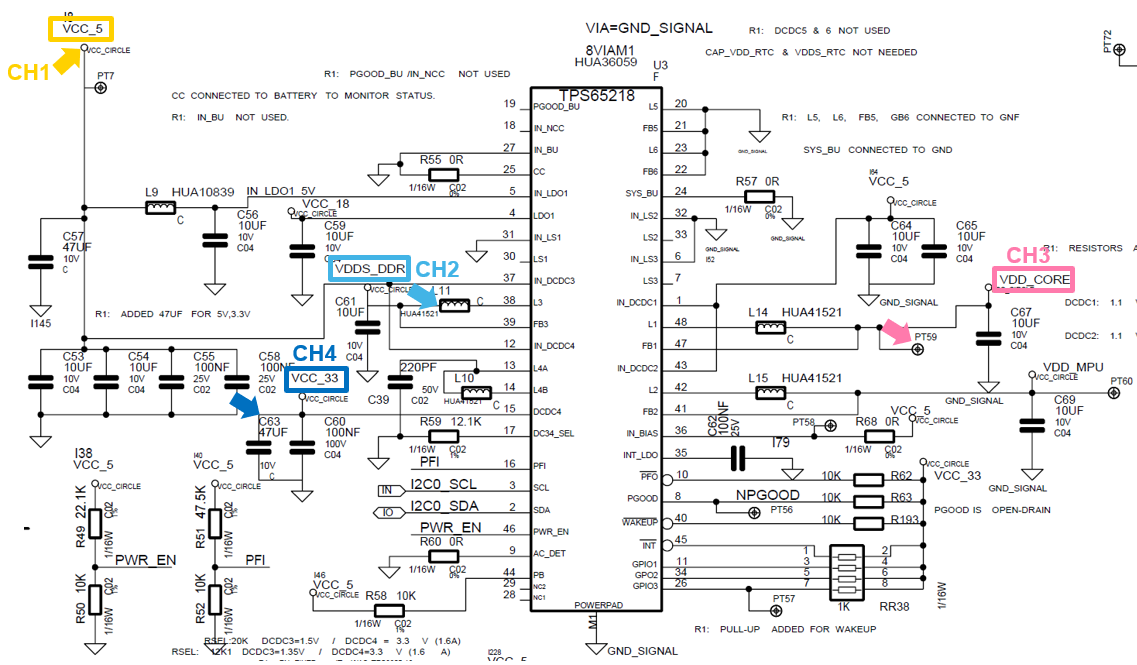

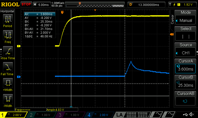

Firstly, PMIC schematic with oscilloscope channel marked for your easy identification.

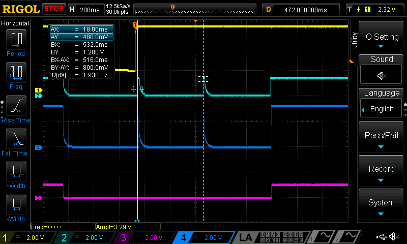

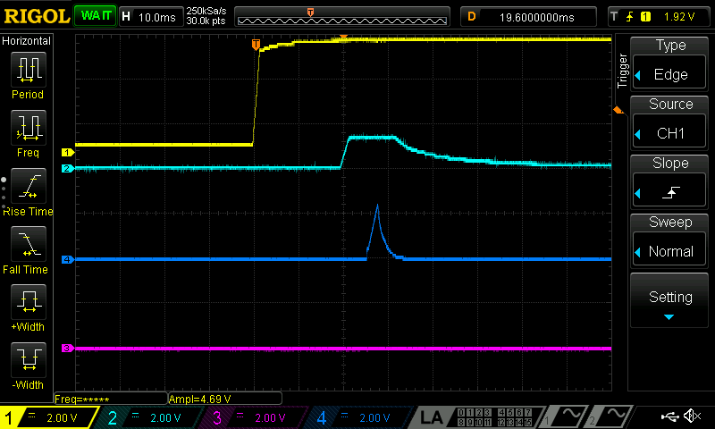

Second, you can see the ocilloscope captures in two cases: Start-up sequence correctly and Start-up sequence failure. These captures were taken in the same module and its performance is fully random.
As you can see in above picture, it has 500ms between each retry to power DCDC4 (3.3V). For more information, I put a ocilloscope capture with detail view of this failure case.
Regarding to pcb layout, We follow the layout guidelines in datasheet: 47uF output capacitance and 1 mm of distance between pad and capacitor.
After that, we think new PMIC sillicon revision (D0) does not fix previous issues detected in -B0 revision. We have observed that some boards seem to start-up even after 8 retries. This performace generates a chained problems many components in our product, including ETH PHY.
My question is: What do you think what is the cause of this behavior? Is there any explanation or root cause for these retries?

    • Why do you have C39 (220pF) populated on new board with TPS65218D0? No workaround is required for -D0 silicon.
    • Can you please provide datasheet for HUA41521? I cannot find inductor part number HUA41521 when I search for it.

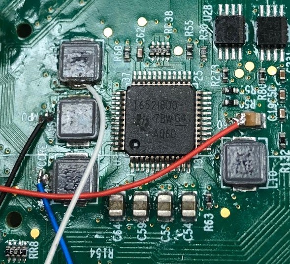

    • Can you please provide picture showing top-side marking of TPS65218D0 IC on-board? Although you have indicated that you are using -D0 silicon, the schematic still says TPS65218 (not full orderable part #) and I need to confirm which IC is populated on-board

    3. Bellow, you can see the picture of PMIC sillicon version. Wires only has been soldered for test purposes.

  • Hello Brian,

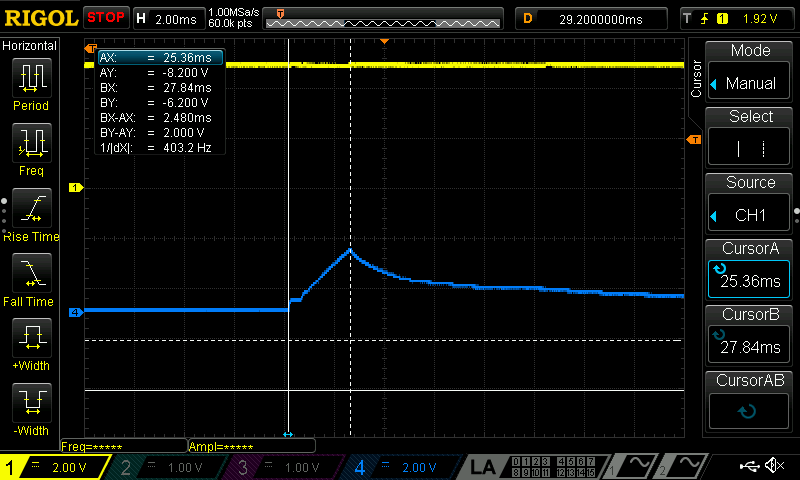

    I come back with tests you asked. Regarding to 5ms of delay to reach 3.3V output voltage, you can see an ocilloscope capture with cursors. The time is 2.4ms when start-up sequence fails.
    We have changed DCDC4 Cout from 47uF to 33uF in our test board used in previous test posted here. Performace seems to be similar to other tests.
    Besides, we have observed this issue is related to temperature as you can see in this attached video. First, we power on the tested board and presents start-up failure explained in these posts. If it applies a freeze spray (CRC minus 50) over PMIC, DCDC4 works instantly. For more information, oscilloscope captures of this video is shown bellow.
    Thanks in advance.
    Best Regards.
  • Thank you for the updates Carlos.
    It is interesting that cooling down the PCB/PMIC resolves the issue very quickly. What is surprising to me is that DCDC4 turns off before it tries to get to 3.3V for the full 5ms. 2.4ms is not even close. It is also interesting that DCDC4 shuts off when the voltage is ~2.4-2.5V (i.e. a diode drop above 1.8V)
    Did you take any scope shots showing the LDO1 voltage, supplying power to VCC_18 net in your schematic? So far, I can see that VDDS_DDR (DCDC3) ramps up quickly and is stable, but I cannot see what is happening on LDO1. If LDO1 starts to rise above 1.8V (due to an unknown leakage path), the fault would be on LDO1, not DCDC4, which would explain the 2.4ms and point to a different problem.

  • Hello Brian,
    Answering your questions:

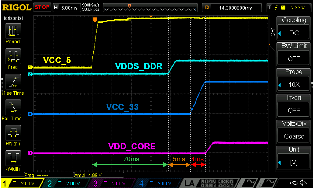

    • Bellow, you can see the oscilloscope captures including VCC_18 with slope details.
    • Currently, we have a production about 500 boards with both PMIC sillicon revisions. Our EMS don't have traceability of how many boards has -B1 or -D0. All affected boards that we have analyzed mount -D0. In the other hand, -B1 boards with 330pF capacitor workaround works right until now. We are trying to collect information as much as possible and carry out several tests in climatic chamber to clarify the root cause.
    Thanks & Best Regards.

    2. There is a poor lead/power PAD connection due to re-soldering new -D0 samples. The leads appear to be soldered down OK, but pins 13-24 (and 37-48) appear to be slightly off-center. I cannot see the PowerPad at all, but I know sometimes re-soldering the PowerPad can be very difficult on an SOIC package.
