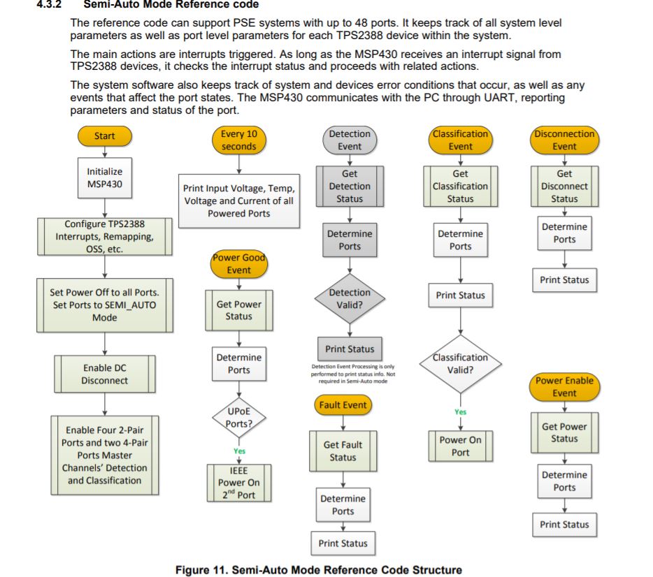

In TPS2388 PSE controller power port MOSFET is not enable, while connecting the valid PoE PD connection.
How to enable the power port? it is required to enable the port from the register level?

    TPS2388 does not have autonomous mode (pass FET turns ON after valid detection/class). Instead it has semi auto and manual mode where you need to do to a power on command from the GUI or host to turn on the port. This is described on 8.6.22 of the datasheet.
    If looking to do autonomous functionality, I recommend looking at TPS23881

    I need information about what are all the register should need to enable the power port after valid detection.
    We are configured PSE controller in Semi auto mode(12h) and we enabled all the bits in power enable register(19h). this only configuration is enough for enable the power port?

    Please take a look at TPS2388EVM-612 user's guide and we have a clear flowchart of what needs to be set(the minimum registers you need to set are: 0x12:set operating mode, 0x13:enable DC disconnect, 0x14 enable detection/classification, 0x19:turn on ports after a valid PD is connected). We also have MSP430 reference code available in TPS2388 product folder to reference to. Thanks.
  • Thanks you,
    Now enable all PoE ports. Thanks for your support sir.
