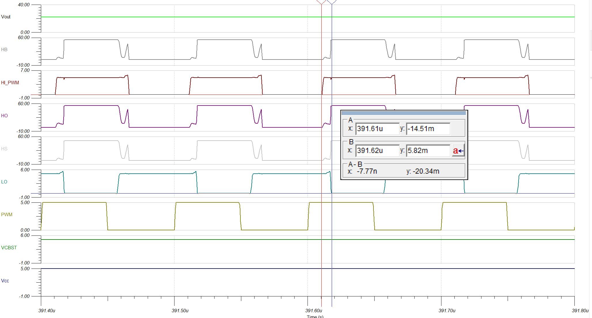

    I can't zoom in the time scale in the waveform viewer below 0.1us. I tried several ways but in vain. Basically, I need to see dead time with 1ns precision. Do you have any suggestions to change the zoom settings.

  • Hi Jeff,
    I tried using the above design file in PWM mode, but the HO and LO signals are overlapping and the shoot through periods are ~8ns. I tried varying the values of the potentiometer resistor connected at DLH and DHL terminals, but I can't see improvements to avoid shoot-through and insert dead time. Can you please help me to resolve this issue.

  • Hi Srikanth,
    Have you been able to zoom closer than 100ns? I think I figured out a workaround. Your current simulation time is 500us, however if you can reduce that to 100us for example the amount you can zoom gets larger. After running the simulation, in the results plot window, click on the x-axis to bring up the set axis pop up window. The precision can be updated however the zoom scale is what you want to change. Say you want to view the dead-time closest to 50.5us, the scale should have a lower limit of 50.49us and an upper limit of 50.51us. This time scale should allow less than 100ns zoom precision.
