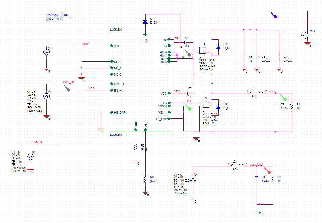

I have downloaded LMG1210 reference design  for EPC2001 and now it is not available in website. Does model have any problem? seocndly, I am not able to increase input voltage above ~55 V. I would be grateful if you can assist with this matter.

    Thank you for your fast reply. I had limited Vin to 18V and I had replaced it with EPC2034 too.  Problem is still existed. I have not changed PWM, but always above ~55V as an input for Buck(VG4 in the simulation) the output is less than 4 V!!! please look at the attached file.

  • Hallo Arash,
    I have just seen that the second version for LMG1210 TINA model was updated, but i have still a same problem. In attachment you can see the simulation file. The only changes from my side is Vin=18V and Vin (VG4)=55 V. As I explained you before, if the VG4 is increased above ~55V, the circuit gets in trouble and output is about 4V which wrong(it must be about 55V/2= 27.5V ).

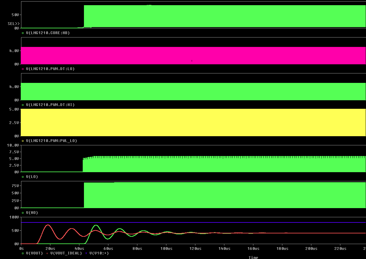

  • Hi, I just checked the new model. Basically a model has to create the correct pulses and voltages at its pins. In your schematic, Ho , HB, and LO were not coming up correctly at pins , so clearly it was not pulsing and thus nothing connected to  the model would have worked .
    With new model I  checked the signals at all  pins and they are correct now. I also did 2 quick tests with ideal switches (with 50 and 80 volts). The LMG1210 worked fine at 80V. Test bench and  output voltage are shown here. It will take a while to replace to old model on the web with this new one.
    I am going to close this ticket as I verified the issue with old LMG1210 model  and new model  is on its way. Thanks for pointing out the problem.
