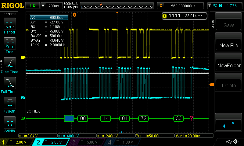

    The keys are now in little endian order. But unfortunately it had no effect.
    I used a i2c decoder to see if there is any interference or i2c code running in between the write buffers, but it seems like they send in the correct order.
    Maybe by little endian you mean both keys together in little endian? Now the steps are separated from each other.
    This is my scope view:
    Thank you for the help!
    Jorg
  • Hi Jorg,
    You have to write 0x1404 first all at once and then 0x7236. Then follow back to back with 0xffff and 0xffff.
