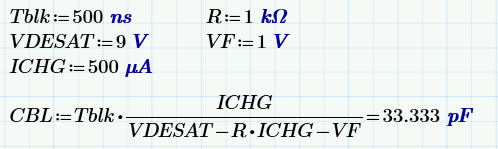

  • Hi Audrey
    Can you check my calculation? If I set the Tblk=500ns, Cblk should be 10 pF order. Is it correct? The pF order capacitor is not too small right?
    Uchihara
  • Hi Uchihara,
    Your calculations are correct. It may be more susceptible to noise because it is a small CBLANK. One thing you could do is to increase CBLANK to 100pF, then add a resistor between OUTH and the DESAT pin to provide more current to charge during turn-on. You could use a 30-kOhm resistor between OUTH and DESAT with a diode in series to block current flow back to OUTH from the DESAT pin. Using 100pF from DESAT to COM and 30kOhm + diode between OUTH and DESAT you will get around 600ns blanking time.
