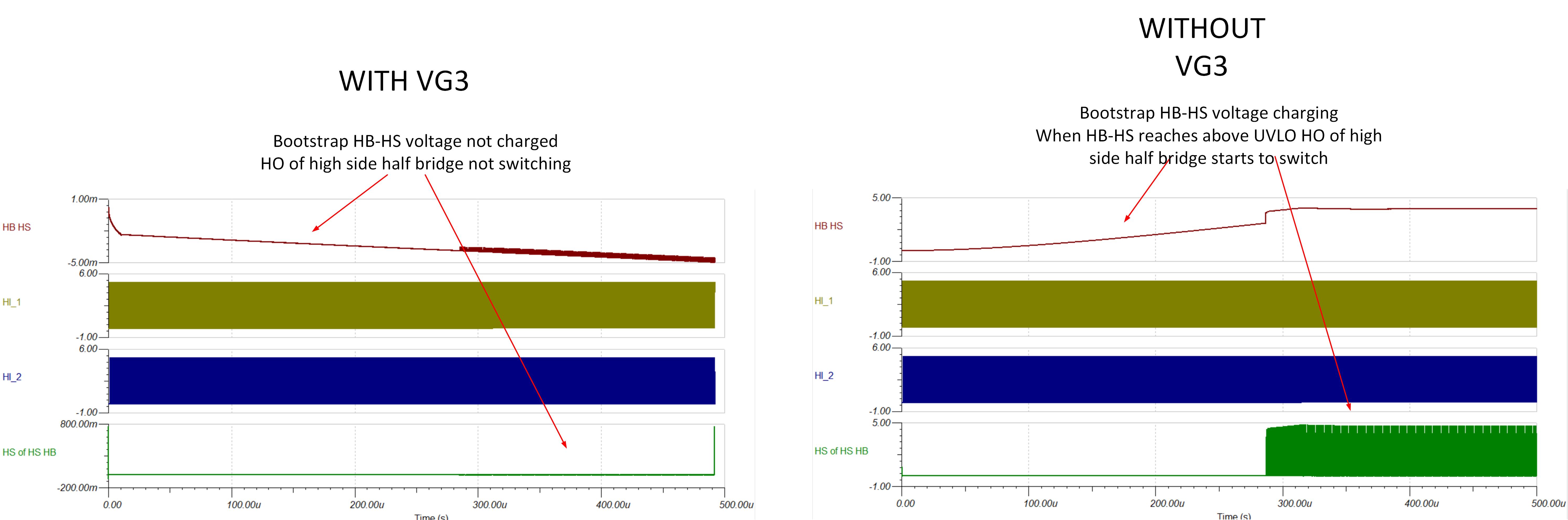

I am trying to simulate a 3-level flying cap buck with the LMG1210. I am not able to drive the topside MOSFET with it. Please find the attached simulation file. Is there any special configuration that is required to drive the top side MOSFETs (like level shifter). Can you please look in to this issue and help me in trouble shooting this.

    I am in progress of investigating this issue and now I believe everything is switching normally when I have removed VG3 which is driving the flying cap as well as made the inputs on the high side half bridge complementary so that they are not overlapping..
    I copy pasted VG8 (hooked it up in reverse) and called it VG7 for complementary high side half bridge inputs (the low side half bridge was operating correctly when I tried running each half bridge individually when debugging this schematic).
    VG3 was making the supply for the bootstrap VIN_3 (with respect to VC+) oscillate on and off so I got rid of it. This voltage, VCBST1 should remain relatively stable at 5V.
    I attached the updated TSC. Let me know if you have any questions.Three_Level_EPC8010_V1.3-2_removed VG3 updated VG7.TSC

    You have removed VG3 that is driving fly cap. Does it have any interaction with the gate drive output pulses? Moreover, it's not supplying bootstrap VIN_3 (not related with VG3) as there is a diode in reverse direction
    In this application, I am operating the converter with duty cycles greater than 0.5, which requires an overlap of high side half-bridge gate pulses. please let me know if this overlap causes any issues.
    And each of the half-bridge has its high-side(HO) level shifted but not the low side(LO).   Does it affect the LO of high side half-bridge which is driving MOSFET T2?
  • Hi Srikamnth,
    With some further investigation the outputs overlapping is ok. VG3 appears to prevent the top switch from operating.See below image how the bootstrap cap voltage operates with and without VG3.

    You are right on the flying capcitor. But the reason that I connected a DC voltage source is to maintain half the input voltage across the capacitor as there is no controller to control the fly cap voltage.( I  have recently started using TINA and it will take signifcant amount of time to implement the control for me)
    I tried by removing VG3, and I am able to see all the gate pulses but still the top side devices are not able switch. And also the boot cap voltage acorss the bottom half bridge is increasing more than 5V.
