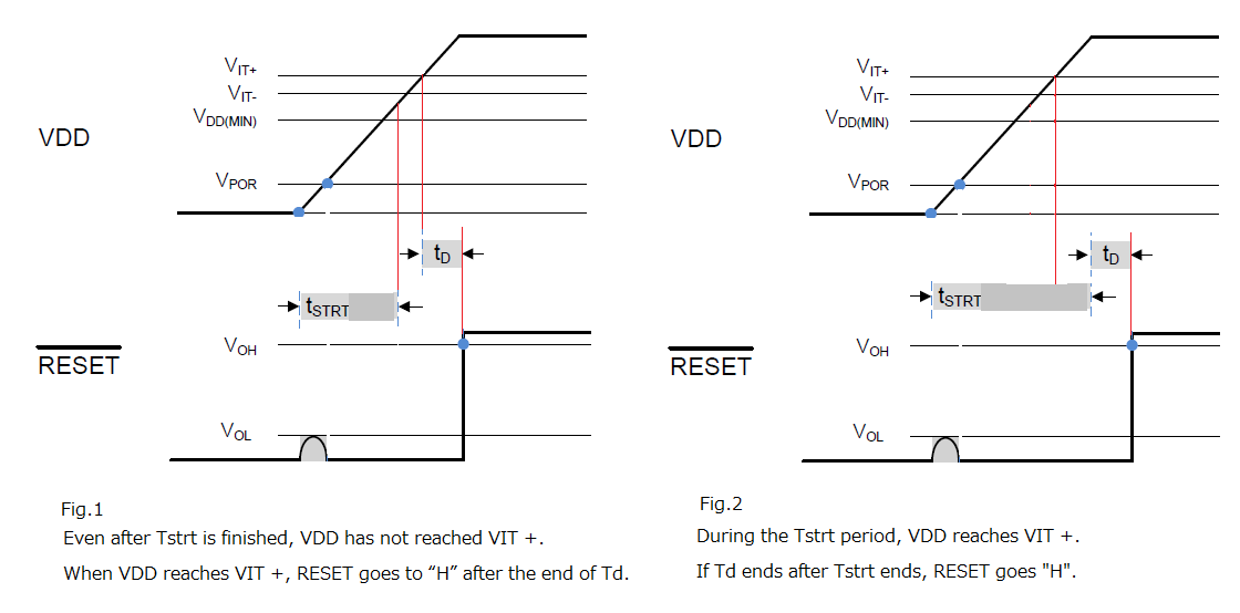

(Question1)
Is the timing of Tstrt starting immediately after VDD starts?
Or is it from the time when Vpor or VDD(min) is reached?
(Question2)
Are the contents of Fig.1 and Fig.2 below correct?
  • Hi
    Some internal circuits are defined only for  >= VDD min voltage. When VDD reaches to VDDmin level then internal circuits take Tstart time to come in functional mode. Hence Tstart time is defined from the point where VDD crosses VDD(min) value.
    Figure 1 is showing when VDD is taking > Tstart time to reach VIT+ in case of startup.
    Figure 2 is showing when VDD is taking < Tstart time to rech VDD. In that case total delay will be Tstart+ td.
