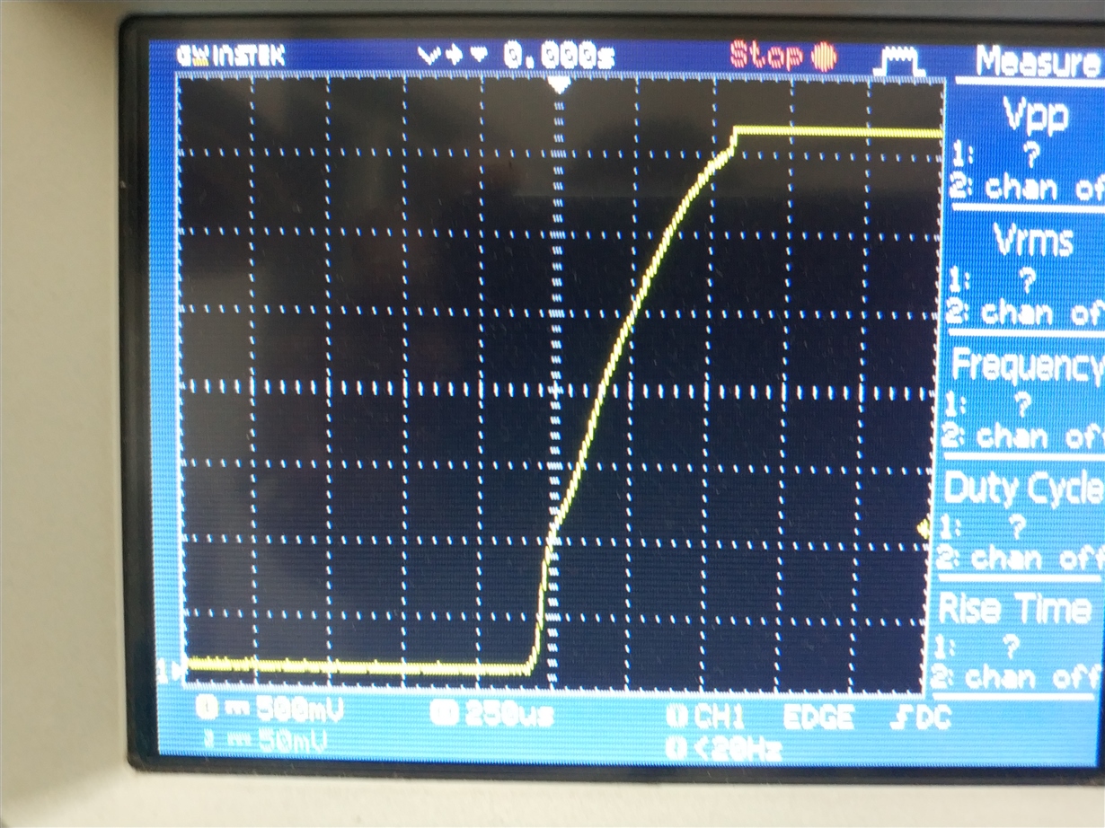

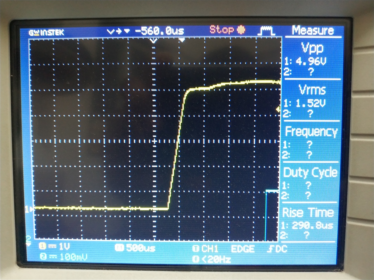

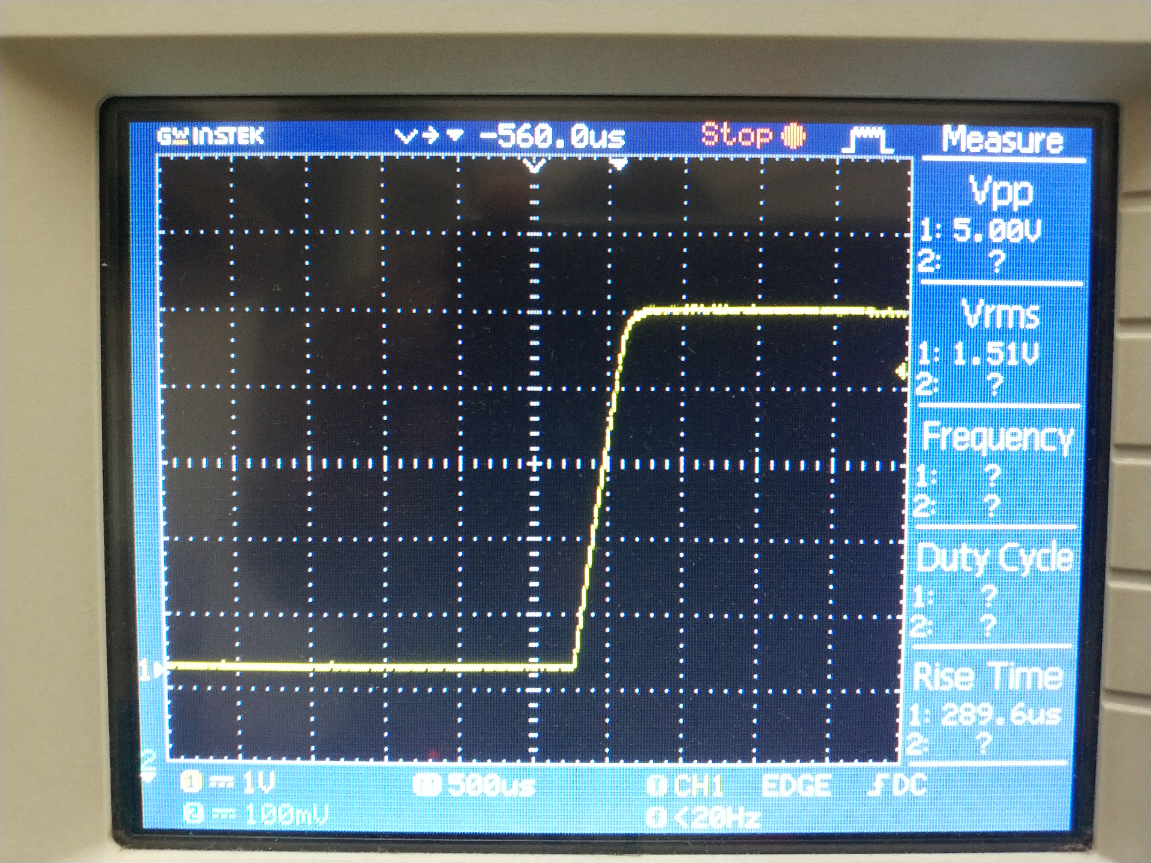

  • Hey Rahul,
    Let's try two things:
    Can you send a waveform showing the following in a single capture:
    1) VIN, VSYS, SW, and ACOK? Please capture on the rising edge of VIN. I am targeting a similar waveform as Figure 25. VIN, VSYS, PH and ACOK During Power Up in the datasheet. Please refer to that waveform and try to capture something similar.
    2) Capture the same waveform above, but please remove the load on system (the 500mW load). I am curious if the issue is related to the soft-start of the converter.
    Joel H
  • Hello Joel,
                        Almost observe the same behavior of signal  which you mention above and in datasheet
        result is same ..!
    we also observe when system is power 'ON'  on battery and load is connected, its shutdown the load  at 13min almost check it 4 time after the power on and after 13 min it going reboot the system and started miss behaving
    we also try to test it on performance mode Reg12(15), observe the same results ...
    Thanks and regards,
    Rahul
  • Hey Rahul,
    Which waveform is which above? I did not notice any labels.
    And I am now understanding that your device works (i.e. system voltage is regulated) for 13min? Then you suddenly remove power and reapply it and it does not work? When it does not work, you mean there is no system voltage?
    Is there any specific event occurring at 13min on the load side or on the Raspberry Pi side? Will it work beyond 13minutes if power is not removed?
    Joel H
