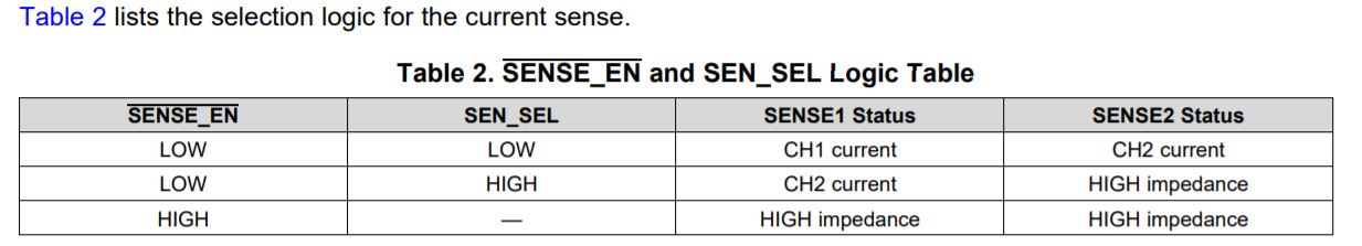

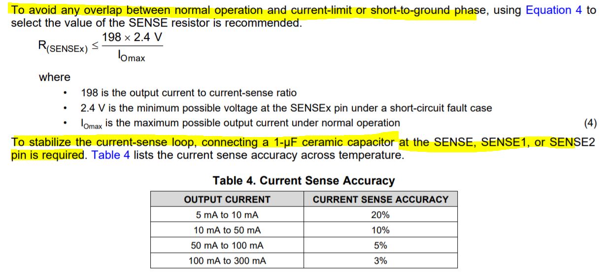

  • Hi Alpha,
    Based on the current from the output2, we normally recommend to have Rsense < = 2.4 x 198 / 0.057 = 8.3K Ohms. You may connect the 10kOhms resistor but as the datasheet suggested. At the same time, have you tried to connect the required 1uF capacitor to stabilize the current sense loop?
    When not in use, I would suggest you disable the current sensing function /SENSE_EN, /SEN_SEL pins. Or you could simply leave the Sense 2 open.
    Will you also provide more details on what tests have the customers tried before they saw the failures?
    Jason Song

  • Hi Alpha,
    We should not have any kind of oscillation in an application in the first place. I would strongly recommend fixing the oscillation by understanding why it's oscillating and takes actions to the SENSE pin if the application does not need it.
    In order to give recommendations on the failures, will you provide more details such as scope-shots and detailed procedures on how the customer is testing the devices?
    Jason Song
  • Hi, Jason:
    Thanks for the feedback.
    the waveform showed in my former attached. In customer application, they need to use the Channel 1 current sense function. So, they can't disable the function.
    For Sense 2, please suggest how to connect if not used. In our datasheet, it recommend connect to GND, can you suggest if need to add certain value resistor?
    And in your former feedback, it recommend left the sense 2 open.
    Can you double check and advise which one we need to use?
  • Hi Alpha,
    When sense 2 is not used, you can ground it or leave it open. By grounding it may help to dissipate heat from this pin to the ground pin copper, and this is recommended by the datasheet.
    Jason Song
