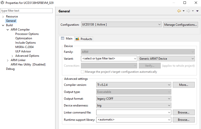

I have a programm "UCD3138HSFBEVM_029" and CCS  Version: 6.2.0.00050 with compiler version TI v5.2.4
2 mounth ago, all be ok. But now, i compile project and have errors:
Project "Lab_1" :
I see this post  But its dont work. Can you help me?
  • The recent version of HSFB code was compiled using compiler version TI v5.2.9
    Could you please install compiler version TI v5.2.9 through the help-> Install new software menu and see if it helps?
  • Hello Sergey,
    I have actually downloaded the HSFB code from TI.COM and compiled it using compiler version TI v5.2.4 on several machines.
    The program compiled fine. Do you have the support for Digital power products or ARM7 in the downloaded version of your CCS?
  • Hello, i try to compile this project on the other PC and all ok. But what are the problems with this machine?
    I am reinstall CCS, and its dont work. it looks like the compiler did not install.
    And this warning: "This project contains 9 unresolved buildable linked resource(s). The project may not build as expected. "
  • Please uninstall CCS.
    Reboot your PC.
    Install the CCS again and make sure in the process of installation you choose to add the support for "Digital Power Products".
    Try to compile gain. Hope this will fix the issue your facing.

  • Hello Sergey,
    If your issue is addressed, please set the status of this post to resolved.
