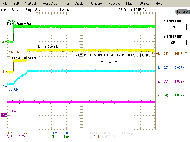

    Outside of cold start I am not seeing any issues with disabling MPPT and applying an external voltage reference. Would in be possible for you to try using a DC power supply with a series resistor to simulate your power source? I would like to see if you can recreate this scope capture of the external reference system working outside of cold start. Please also provide your VBAT voltage.

    Thanks for the graph. I guess VSRC is the VSTOR, right?
    Where is the boosting between Vindc to VSTOR using the external variable VREF? (while VSTOR=OCS to disable MPPT) ?

    To apply an external reference your device must be out of cold start. VSRC is the voltage from my power supply as I do not have access to a solar cell. VIN_DC is what the chip sees at its input. I have labelled my setup in one of the attached images. In the experiments attached I set my power supply to 3V and provided various external reference voltages. In all three cases, the BQ25504 was able to regulate VIN_DC to the desired setting.

    In my experiments my device is seeing small voltages at the input (1V, 0.7V, and 0.6V) and boosting up to 3V at VSTOR. The device is operating as a boost circuit. I am using the same reference board you have linked. I have positioned JP1 so as to short OCS and VSTOR in my experiments to disable MPPT.
    It is up to you as the customer to determine the optimal VREF value for your specific energy source. If you provide me with that value I will be happy to recreate it to the best of my ability in the lab and provide you with my results to compare to yours.
    It is acceptable to short OCS and VSTOR to disable MPPT while applying an external voltage to VREF.

    I have recreated your setup to the best of my ability using Rsrc = 75k. I am not seeing any issues. On the scope shot where I show VSTOR charging up to 3.28V I disconnected the battery to speed up the charging process as the VSTOR cap behaves as a small, quick charging storage element.
    Unfortunately I will not be able to assist further without scope shots from you or further information about your setup.
