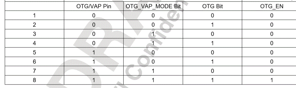

Here are several question about OTG from customer. Please kindly help to check:

4. What's the criteria to make device switch from OTG back to charging mode? Any response time spec?

    4. Below truth table summarize the logic to go out of OTG mode. Response time should be aournd 10ms.
