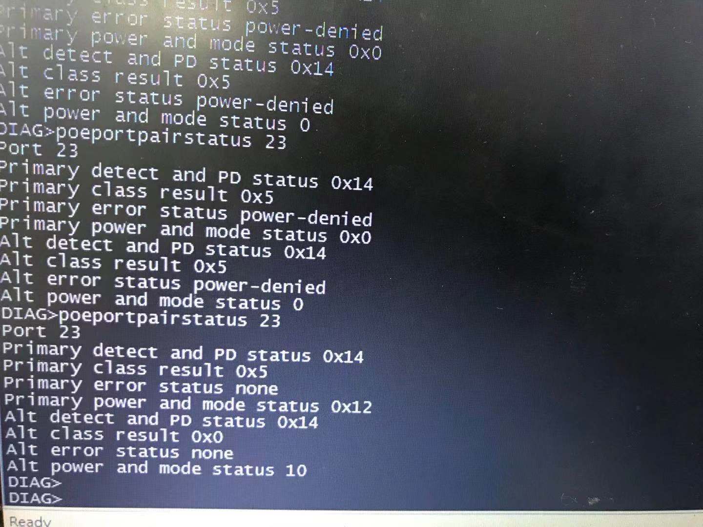

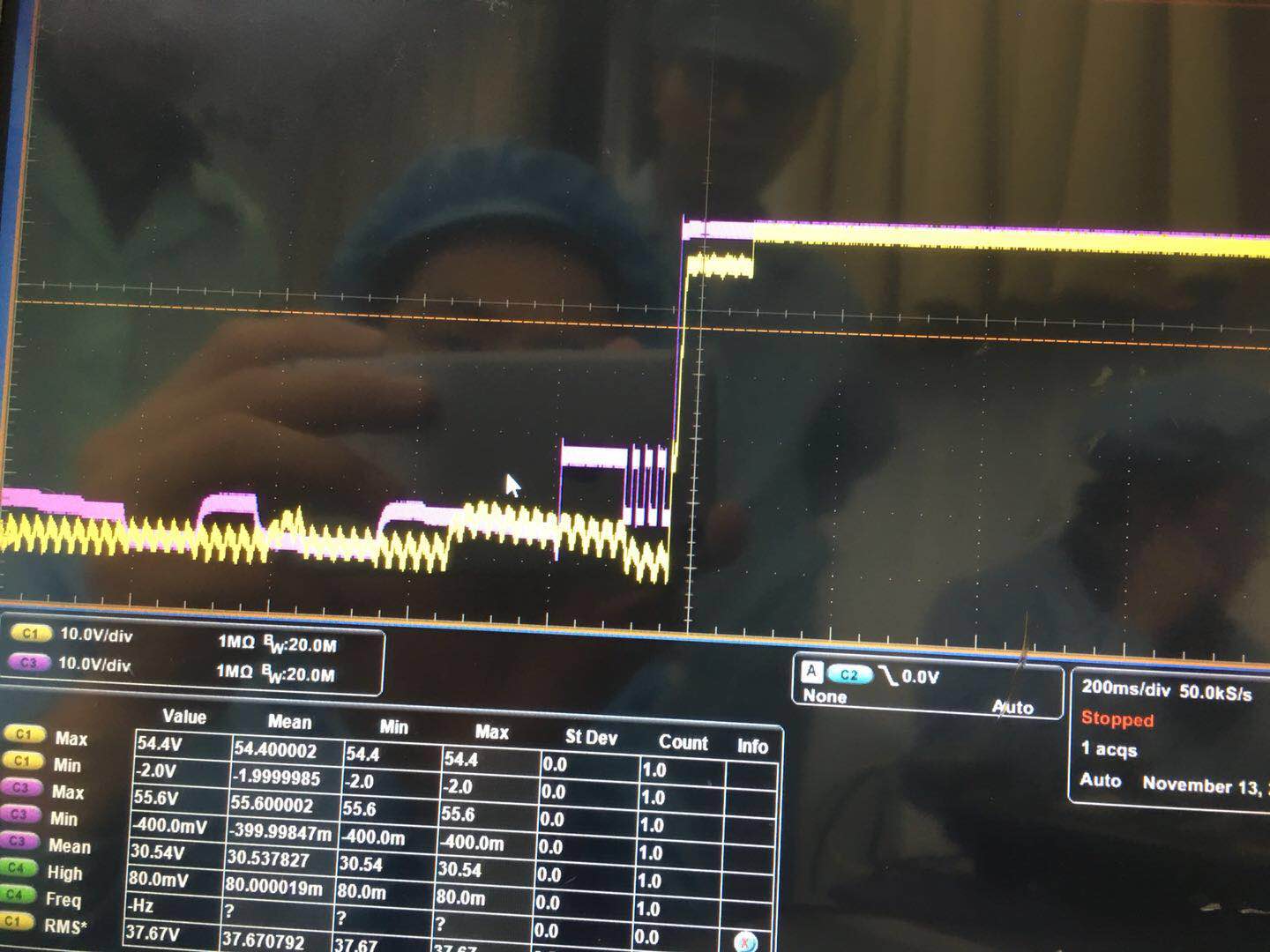

Hi Darwin,
Now we have a problem.
The waveform is dual signature. By this waveform we can find out on TPS2372 can be classified well but the other one is fail.
Through the PSE debug message, it shows one is class 5 and another one is class 0.
But if 2 PD total power is less than 20W, both of 2 PD can be classified to class 5.
Should we change Rcls or there is another problem?
