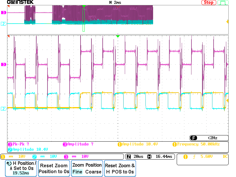

When i increase the input voltage, which is 150Vac, the fuse on the input side blown up and my MOSFET (right leg, upper side and lower side) broken. I analyze the problem using oscilloscope after i replace the broken MOSFET. Here is the picture of the wave.
(yellow: OUTB, blue: OUTD, purple: transformer output)

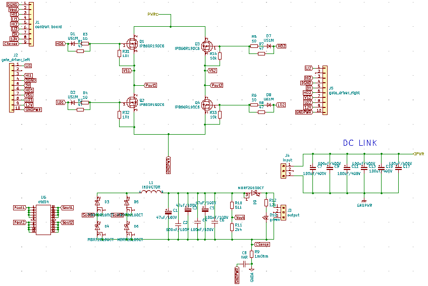

this wave was supplied by 30Vac, which converted to dc by multiplying with 1.414. I guess i have no problem with soft starting as it only place capacitor. Here is the schematic:
Please let me know where is my mistake, as i want to finish it to my final project.

    Looking at the waveforms you posted you can see that the OUTB waveform is ok. The first OUTD waveform in the burst of pulses is occasionally shorter than usual - this behaviour is expected and is noted in the data sheet under Figure 1. This won't cause problems if you are using gate driver transformers but if you are using a high side driver IC (UCC27714 or similar) you must be careful with the layout to make sure that the narrow pulse can charge the bootstrap capacitor sufficiently.
    Having said that, I don't think that the driver circuits are the problem. There is a lot of ringing, or high voltage spikes on the transformer waveform. This tells me that there is a lot of unclamped inductive energy in the transformer circuit - perhaps long traces from the transformer to the rectifiers or long traces on the transformer primary circuit. The transformer leakage inductance can also cause these spikes.
    You should review the secondary snubber circuits and their layout. Spikes like this have a lot of high frequency energy so the snubber circuit must be laid out carefully so that it is effective at these frequencies.
    I'd suggest that you disable the SRs by disconnecting their gate drivers and connecting their gates to their sources. The SRs will then behave as diodes.
    You can use TVS (Transient Votlage Suppression) diodes, sometimes called Transils, to clamp the spikes so that the SRs (Diodes) do not avalanche. This should prevent them from failing while you investigate the root cause of the problem.

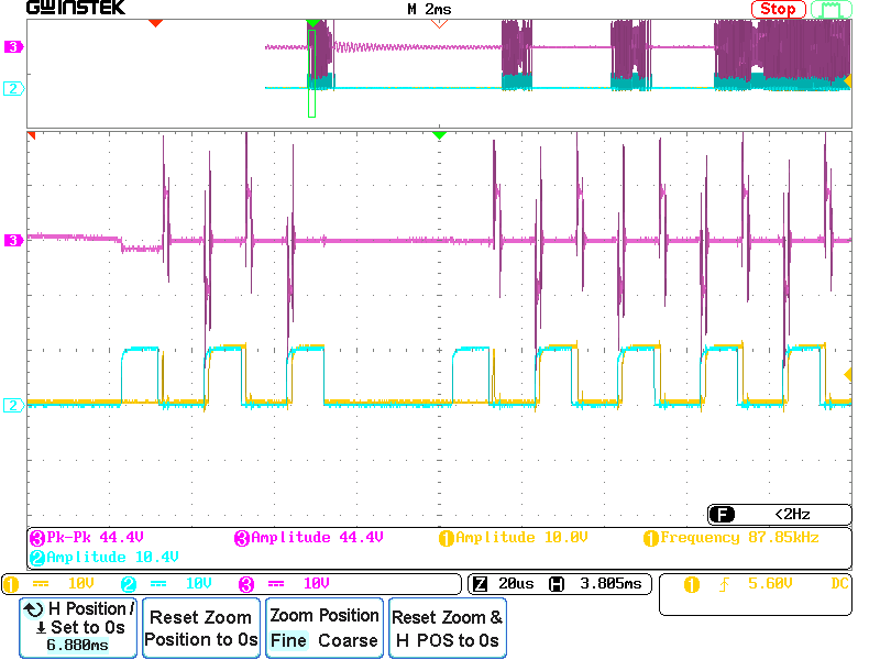

    Also i have some pictures to take attention on it, because it looks so strange. This is the picture:
    The start up process begun again in the middle of the waveform, not only at the beginning since the controller is turned on. Could you give me an explanation about that? Thanks.

  • Hello Hanif
    The Current Sensing is located in the wrong place, it should be sensing the input current to the bridge not the output current. The system is giving you alternate Dmax and Dmin pulses - almost certainly because of the incorrect current sensing.
    Colin
  • I'm sorry, that was my old current sensing method. I'm not using R-shunt anymore, and using TA12-100.
  • Hello Hanif
    That's ok, the current sensing method does not matter as much as the current sensing location. The current must be sensed at the input to the bridge.
    Please let me know how you want the output to behave if there is an overload ? Is a simple current limit which is relatively inaccurate ok or do you need an accurate CI/CV characteristic like that needed for battery chargers.
    Colin

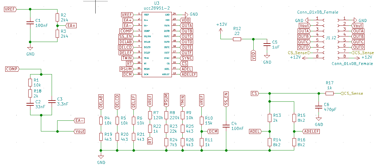

  • Hello Colin,
    Actually for this stage, i just want my converter works as safe as it can, like the MOSFET isn't getting hotter, no hissing in transformer and induktor, so i can take another step to designing battery charger.
    And also i'm little bit worrying about the COMP pin, the component is only resistor and capacitor get parallel together, how significant it will affect if i change those numbers?
    Thanks.
  • Hello Hanif
    The compensation network, C2, C3, R1, R18 is correct although you may need to adjust the values.
