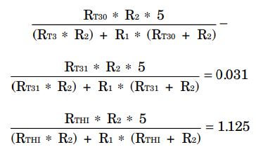

I have a question about "page 7 Configuration the TS input to the bq2000T for ⊿T/⊿t Termination" description in following link.
I read it but I couldn't understand what it explains.
What does 0.031 and 1.1125 stand for in equation in page 7?
What is RT2 value?
does this calcualation affect R1/R2 value?
What does this session want to explain in the first place? how to choose thermistor?
Kai

       The 1.125, and 3.875 values are derived on the previous page (page 6). The deltaT/deltat termination condition corresponds to 31mV/min at 5V supply (0.031 value), and from this equation, the 1.125V value is derived. I do not see where RTH2 is, but RTH1 is referring to the high temperature cutoff resistance.

    Sorry but not RT2 but RT3.
    still unclear...
    I know your comment is coming from page 7 and I can read it but I couldn't understand that detail.
    From following equation, we can get 0.031 value and this is leading 31mV/min with a 5V VCC voltage (VCC/161).
    What does this 31mV/min mean?
    if we take this at face value, 31mV increases per min.
    where is starting voltage of 31mV and when is starting point of minutes?
    from following test condition(R1/2 datasheet figure 11), TS voltage at 0C(RC=2.449k) is 0.1496V.
    if 1C increases from 0C, 31mV*1=31mV increase? 0.1496V+0.031V=0.1806?
    This is odd since TS voltage should decrease when temperature increases.
    R1=12.4k
    R2=20k
    thermistor=102AT
    thermistor temp range=0~85C
    RC=2.449k
    RH=0.1751k
    R2||RC=2.182k
    R2||RH=0.1736k
    TS voltage min = 0.1736k/(12.4k+0.1736k)=0.0138
    TS voltage max = 2.182k/(12.4k+2.182k)=0.1496
    Also how does 1.125 values is used?
    in addition, regarding following comment, what does "range of 0 to 40C with 1C/min senstivity at 30C" mean?
    does this mean it takes 1min to increase from 30C to 31C?
    if so, how do i think 0~29C and 32~40C?
    "Selecting a low beta thermistor such as the Semitec 103ET-2 together with a 40°C cutoff affords a range of 0 to 40°C with a 1°C per minute sensitivity at 30°C. "
    anyway, I couldn't understand "configuring the TS input to the bq2000T for ⊿T/⊿t" explanation so please explain with more easy explanatnion.
    Kai
  • Hi Kai,
        ⊿T/⊿t termination for NiMH is a termination condition in which temperature of NimH cell is monitored to determine full charge. Essentially slightly excess charging of NiMH is converted to heat and dissipated which is why deltaT/deltat (termperature change) is a valid NiMH termination condition.
    5 degree C over ambient temperature was selected as a valid temperature delta for BQ2000T to assume NiMH termination, and this correspondeds to a ratio dependent on VCC i.e when there is a -VCC/161 +/- 25% tolerance V/min change on TS, then  ⊿T/⊿t termination is detected. (These values are form EC spec) For V/min we are talking about ⊿V on TS not 31mV increase on TS voltage. You are right that with an NTC if temperature is increased, it will correspond to lower voltage on TS.
    30C corresponds to this 5C above ambient temperature, so sensitivity of thermistor should be fairly accurate to guarantee that when BQ2000T samples TS, that it will be able to sample the 31mV delta that would correspond to termination. A thermistor’s beta value, is an indication of the shape of the curve representing the relationship between resistance and temperature of an NTC thermistor. The 40C corresponds to the cutoff temperature, so when temp at 40C, the voltage on TS would correspond to VTCO. It is not 0-29 and 32-40.
