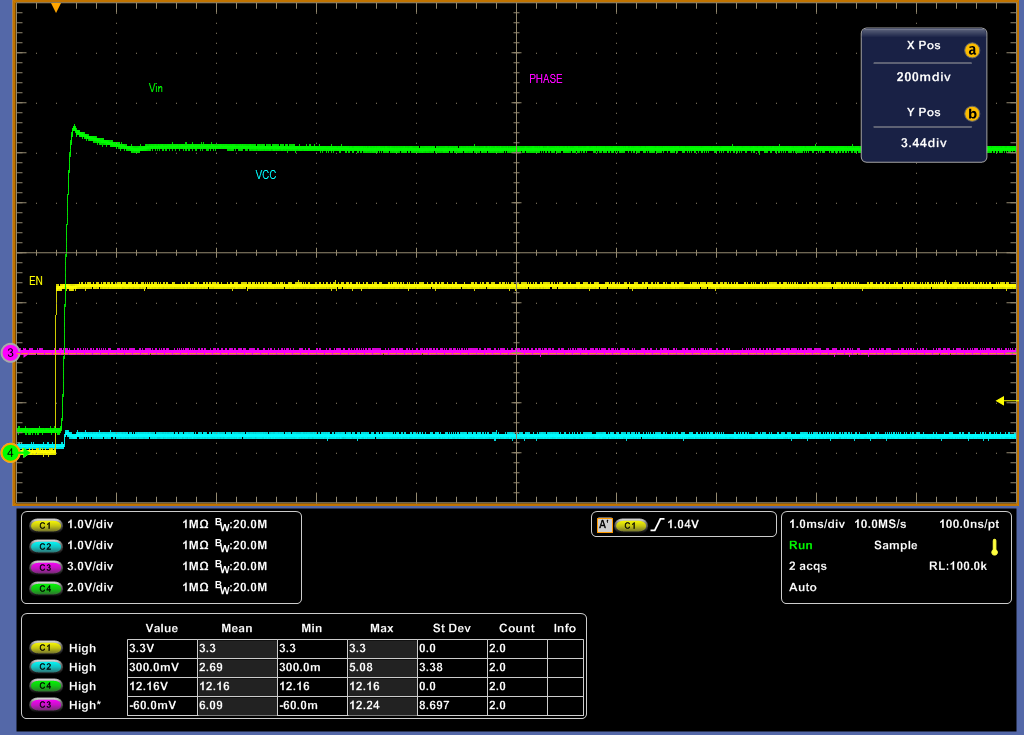

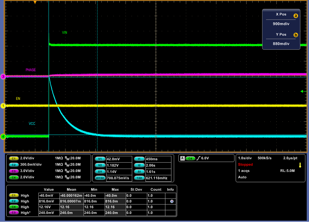

Power rail random failed_ No output, failure rate: 4/100
Following waveforms are normal and fail, What condition will cause VCC on output?
[Normal waveform]
[Fail waveform]

I have questions as below
1. What condition can cause VCC no output?
2. Why I just provide VIN=12V (EN=0V) VCC can rise to 1.18V

Why you ask 12V transients problem? We are use power supply for testing/debugging this issue. Not Battery. You can see the Vin max ~13V from the waveform.
The failure waveform of both VIN and VCC already attached before. So we want to know why VCC can't power on while Vin and EN are ready? in the other words, what kind of condition will cause VCC can't power on?

Hi
Please see attachment. We list 3 questions and attached waveform for your check.
