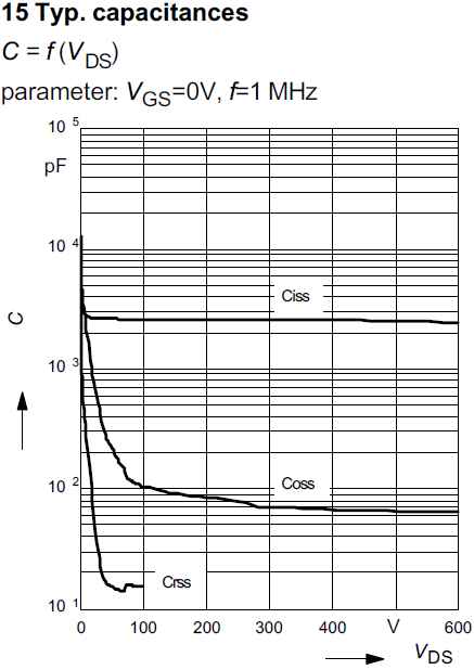

    2. Why equation-56 and equation-88 in UCC28950 datasheet are different? VdsQA and Vds_spec are the values found from its MOSFET spec. Vinmax and VdsQE are the actual operating values.
    Equation-56:
    Equation-88:
    SPP20N60CFD Typ capacitance:
    Based on the above typical capacitance curves, Coss is inversely proportional to Vds. So, Equation-56 should be correct while Equation-88 should be corrected where Vds_spec should be divided by VdsQE, right?

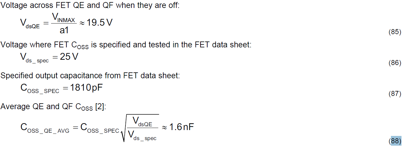

    3. Is Equation-85 correct? Because a1 is the ratio of 1-3 to 10-12 or 7-9. It should be: Vinmax/(a1/2), right?

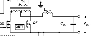

    4. Are QE and QF switching at Vds of Vinmax/(a1/2)? They do not have ZVS? Their switching loss is the dominant of their total loss.

    2/ The reason for the difference between eq 56 and eq 88 is that the primary side fets are used at 400V but their Coss is specified at 25V so the ratio is sqrt(25/400). The SRs are used at 19.5V but their Coss is also specified at 25v so the ratio is sqrt (19.5/25). HOWEVER – I would make Three important points. First, eq 85 is wrong – there is a factor of 2 missing so that the Vds_QE is 2*19.5 or 39V. This would change the equation used to calculate Coss_QE_AVG from that in eq88 to that in 56 !. Second, the behaviour of Coss with voltage is extremely non-linear so any average value will be an estimate. Some MOSFET data sheets give an equivalent Coss value which takes account of this non-linearity and would be a better estimate than that calculate in the data sheet. Third, Coss is not the only capacitance loading the switched nodes. There will be additional parasitic capacitance from the device tab to ground and a distributed interwinding capacitance on the transformer and shim inductor.
    The main point is that the calculations here are only first pass estimates.
    3/ You spotted the error in Eq 85 !
    4/ The SRs always switch at zero volts. See the diagram at  /cfs-file/__key/communityserver-discussions-components-files/196/8204.PSFB-Switch-Transitions.pptx

    2. Since 25V is from its datasheet, ...... 25V is just the point at which the Coss was specified for the particular devices chosen for the primary and SR FETs. It's just a coincidence that the same voltage was used for the two devises. The reason one is in the numerator and one in the denominator is that in one application the working voltage is greater than the test voltage so Coss_avg would be lower and in the other application the working voltage was lower (19.5) than the test voltage so Coss_avg would be greater. The 19.5V was in fact an error, it should have been 39V and in that case the Coss_avg would be lower than the value in the datasheet. If the data sheet gives an equivalent Coss value then that would be a better value to use.

    2. I agree with you that Coss_avg would be lower than Coss_spec for working voltage greater than test voltage. Let us look into equation-88 in details as captured below.
    Capture above is from its datasheet where its working voltage is 19.5V, which should be 39V. Just assume the working voltage is 19.5V first. 19.5V working voltage is lower than the specified test voltage at 25V. Calculated Coss_avg based on equation-88 is 1.6nF, which is lower than 1.81nF of Coss_spec. This result shows that Coss_avg would be lower than Coss_spec for working voltage lower than test voltage. This is contradicting to what we agree.

    2/  You are correct - I should have spotted that.

    For phase shift full bridge, the MOSFETs switch on at zero voltage. Do they switch off at zero current? If no, why there is no MOSFETs switch-off loss included?

    the MOSFETs switch on at zero voltage but they do not switch off at zero current. I expect that we did not include switch off losses because the MOSFET channel can be turned off in a much shorter time than the ZVS transition times. If the MOSFET is turned off slowly, then it will dissipate some of the energy that would otherwise be available to drive the ZVS transition so fast MOSFET turn-off is advisable.
