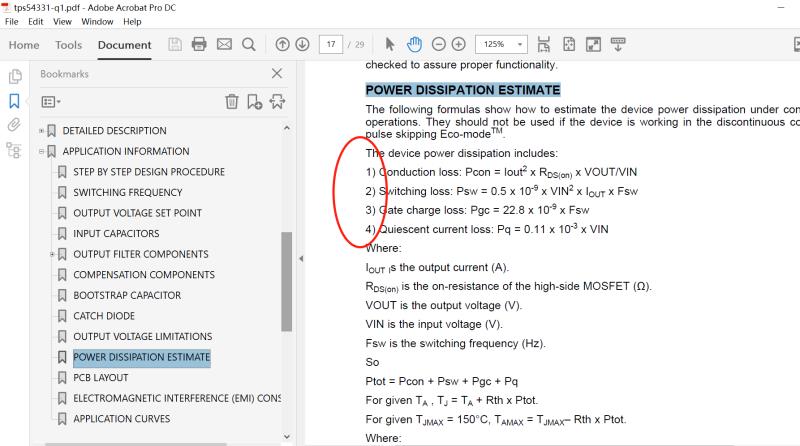

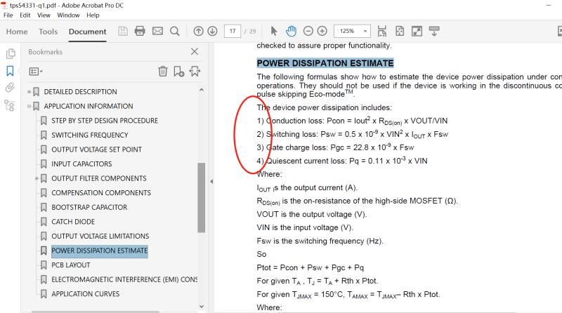

LMR33630-Q1 heating calculation.
Is LMR33630-Q1 similar to TPS54331-Q11 heating calculation?
Hi Neal,
As far as power dissipation estimation, i would use efficiency curve to estimate the power dissipation.
Maybe the presentation below will help. There is some method on calculating thermal on this part.
PCB Thermal Design_with_UltraSmallFlipChipPackage_HotRod.pptx
