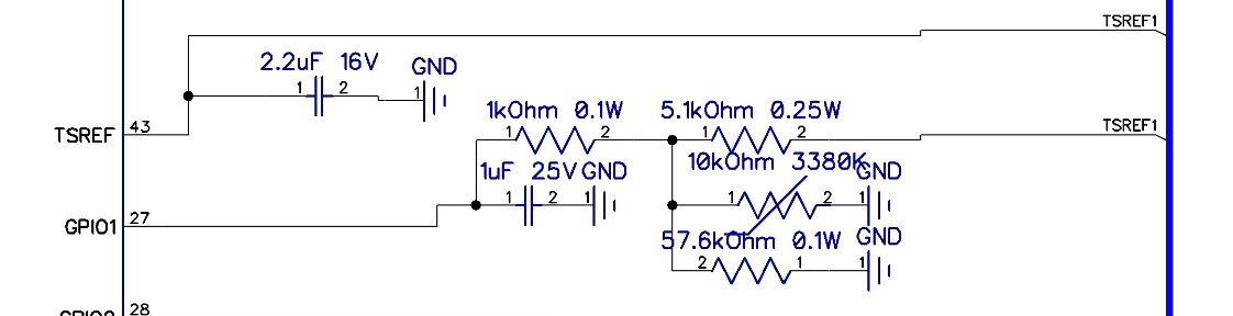

We are using Temperature sensor configuration on GPIO1 Pin of IC BQ79606A.
As per given in data sheet we have performed below steps for calculation of Temperature in degree Celsius.
step 1:
ReadReg(0x00, AUX_GPIO1_HU , 3, 0, FRMWRT_SGL_R);  // read 3 byte of data starting from address AUX_GPIO1_HU  register
step 2:
Temp_Reg_2sComp = TwosComplement_24bit((int32_t)((int32_t)BMS_Rx_Data.response_data[0] << 16) | ((int32_t)BMS_Rx_Data.response_data[1] << 8) | BMS_Rx_Data.response_data[2]); // taken 2s complement of 24 bit data
step3:
TSREF = (Temp_Reg_2sComp  * MUL_TSREF);
step 4:
BMS_Parameters.Sense_Temp = (1 / (((log((R1 * R2 * TSREF)/ (R0 * (R1 * TSREF - R2 * (1 - TSREF))))) / TEMP_COEFF) + (CONST))); // Final temperature reading
the ref values used in the program are listed below :
#define TEMP_COEFF                (3380)
#define CONST                         (0.04)        //(1/25)
#define R1                               (5100)
#define R2                               (57600)
#define R0                               (10000)
#define MUL_TSREF                 (0.00007628)
#define ENABLE_TSREF                        0x10
#define START_CELL_ADC_CONV         0x01
#define START_AUX_ADC_CONV          0x02
configuration of temperature sensor registers is as per below list:
AUX_ADC_CTRL1 = 0x11
GPIO_ADC_CONF = 0x00
CONTROL2 = ENABLE_TSREF | START_CELL_ADC_CONV | START_AUX_ADC_CONV
But we are not getting any variation in temperature reading even if we change the readings to hi- low extremes. Please review the above steps and give your suggestion.
I have attached the file which we have used for TEMPERATURE CALCULATION.Temperature Calculations.xlsx
Thank you in Advance.
Mandar S

    Can you provide the following information on your setup:
    • Are you utilizing a "BQ79606EVM-897" EVM device, or your own custom design?
    • If this is your own custom design, what is the schematic circuit and thermistor you are utilizing for the GPIO temperature input.
    • If this is the EVM, what thermistor (value and model) are you utilizing for this design, and how are you connecting it?
    • What is the unchanging temperature you are getting (is it the value in the provided Excel file)?
    • Can you provide what you are doing in your "TwosComplement_24bit" function?
    Thank you in advance for your response!
    Vince

  • Hi Vince,
    Thank you for your response!
    Here are the details:
    -Are you utilizing a "BQ79606EVM-897" EVM device, or your own custom design?
    >> We have custom design as per specified in DS.
    -If this is your own custom design, what is the schematic circuit and thermistor you are utilizing for the GPIO temperature input.
    >>attached the schematic for TS interface.
    -If this is the EVM, what thermistor (value and model) are you utilizing for this design, and how are you connecting it?
    >> Thermistor part number: NCP18XH103F03RB
          other details in attached schematic
    -What is the unchanging temperature you are getting (is it the value in the provided Excel file)?
    >> Yes, as per excel sheet
    -Can you provide what you are doing in your "TwosComplement_24bit" function?
    >> here's the function,
    int32_t TwosComplement_24bit(int32_t rawData)
        if((rawData & 0x00800000) == (0x00800000))
            return ((~rawData) & (0x007FFFFF) + 1);
        else
            return (rawData);
    -The AUX ADC that is used for the GPIO is not continuous, so you will need to set the AUX_ADC_GO bit each time you want a conversion to be run. Please see section 8.3.4.4.1 of the datasheet for more details regarding this.
    >> Yes Vince, We are enabling the AUX_ADC_GO every time and we check DRDY_AUX before reading the result from AUX_GPIO1_HU/MU/LU register.
    -Additionally, ensure that TSREF_EN is not being turned off in any subsequent writes to the CONTROL2 register.
    >> no, TSREF_EN is not getting changed anywhere else in program
    Mandar S.

    What we are observing is, Using formula in degree Celsius unit is not allowing result to change even after readings are changed to full scale
    unlike this, if we calculate in degree kelvin then we can observe the change in final temperature if we change the input block in attached xls sheet.
     TemperatureCalculationsoCoK.xlsx  contains 2 sheet
    1. Calculations in degree Celsius
    2. Calculations in degree Kelvin
    you can try varying "Input" block in both sheets to see the changes in final reading in "Result" block.
    Kindly confirm whether we are on right track.
    Mandar S.
  • HI Mandar,
    There are two equationsin the datasheet. It's depends on how you connect your thermistor.
    It seems like you have to use another equation.
    Can you double check the equation in the datasheet?
    Roger
