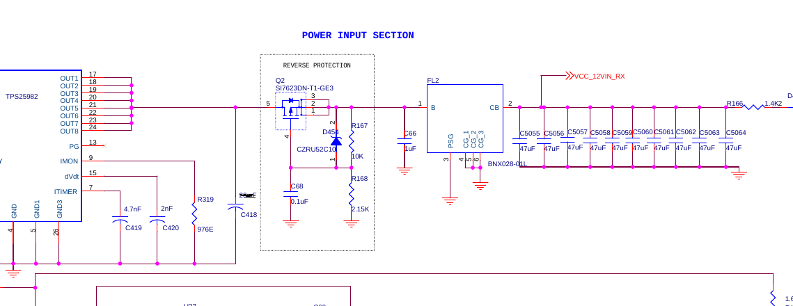

Hi TI team,
Greetings for the day.
We are using TPS25982 e-fuse in our design. I have attached schematic which we are using below. I have placed LDSTRT with 0ohm resistor based on our earlier discussion. My total load is around 15A. When i connect my boards, after 2.5A load it is getting shutdown.

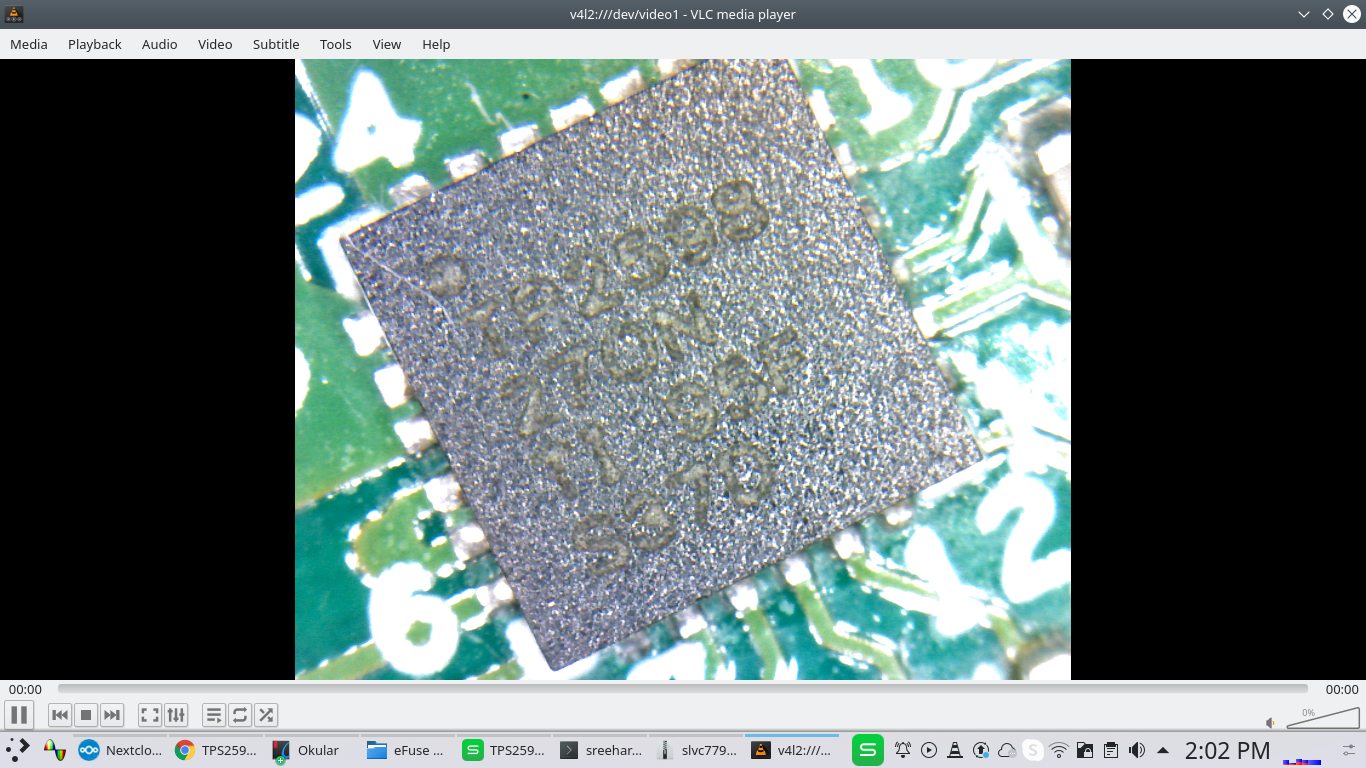

I have observed package name on device as TP259827ON 11 S5F S37D. I have attached package screen shot below.
Kindly let me know if i do any mistake on schematic side or By seeing IC package name can you suggest me either we are using right one or not?
Waiting for your reply.
