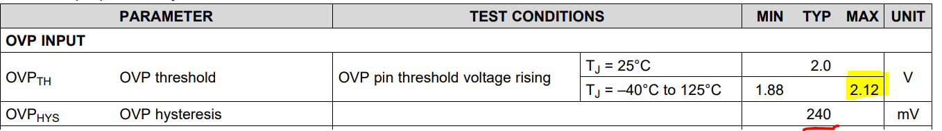

I am seeing the same issue: The EN pin does not work near (but under) OVP = 2V. Instead, it works when OVP < 1.76V. I am expecting the EN pin to also work when 1.76V < OVP < 2.0V since OVP_th is 2.0V per the table in section 6.5 in the datasheet.
OVP shutdown *does* work properly when OVP < 1.76V and then raised to OVP = 2.0V.  This is great!
Please confirm that EN does not work when 1.76V < OVP < 2.0V. Also, could you please update your datasheet to be very clear about this fact? It is a small, but important thing.

    The max rising threshold of OVP is 2.12V to ensure that it shutdown for OVP event (considering process and temperature variation). Also, to release from OVP event, the OVP pin voltage has to drop below (2V-240mV) = 1.76V. Please refer Figure 12 in the datasheet.
    EN control does not work as long as the device stays in OVP event. I will take care to add a comment in next datasheet revision.

    I would expect OVP to trigger anywhere between 1.88V to 2.12V. Can you please double check and confirm on the 1.76V threshold. Are you measuring using Digital multi-meter ? Is there any noise ?

    When the part is disabled (EN=0), the control logic shuts down all the internal circuit (including internal references) to minimize the quiescent current. When the part is re-enabled (EN=HIGH), the external OVP pin voltage has to be below the hysteresis voltage (1.88V-240mV = 1.64V) to keep the device out of OVP state.
    In general, we have not faced any concern for LM5060 applications as the UVLO cut-off, nominal operating voltage and OVP cut-off are used well apart. I will take action to add comment in next datasheet revision.
    Please continue with your approach of raising OVP. Thanks!
