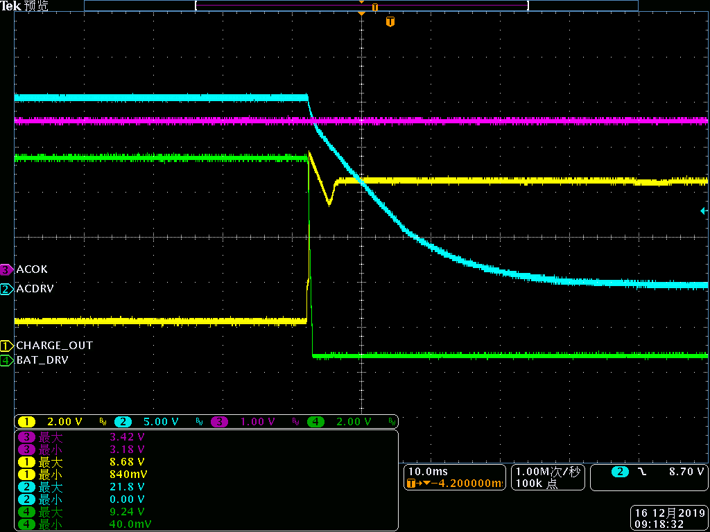

BQ24770: Adapter will be cut off issue when plug in battery
Part Number: BQ24770
Adapter will be cut off issue when plug in battery dt362gl_r10_dsn0924.pdf
describe:
        Plug in 15V adapter first, then plug in Battery(2S battery, battery voltage about 7.3V~7.6V), Adapter will be cut off (ACDRV is be pulled low). after 15S ACDRV will release.
