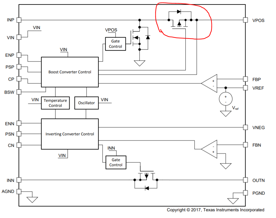

Hi Expert,
From datasheet,I can see, for Boost circuit, we use rectifier diode to discharge the inductor. But I still see a PMOS inside our IC. What is the function of this PMOS.
The PMOS is shown below. Thanks and Happy Christmas!

Hello Wilson,
This switch is used to maintain continuous conduction mode even at very light output load. Without this switch, it is possible that inductor current will become discontinuous at light load operation.

Hi Liaqat,
Thanks for your reply.
At heavy load, will this FET still on?
Wilson

Hi Liaqat,
In order to debug in customer's board, I need to know the behavior of this MOS. If confidential, you could send me email. Thanks.
