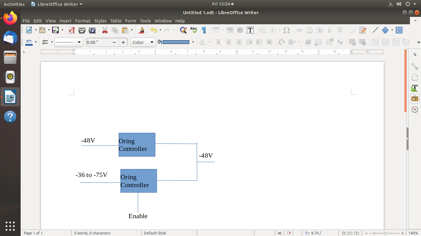

  • the requirement of oring two -48V supply. I want the oring circuit with enable pin. Because other input is -36 to -75V .
    -36to -75 V ored with -48V. [quote user="Navneet Diwakar"]

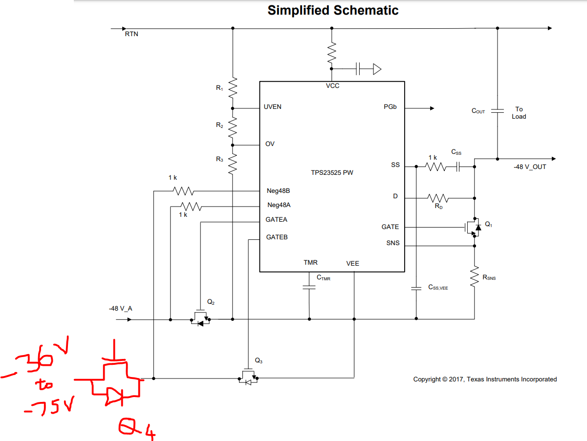

  • Hi Navneet,
    I suggest to use TPS23525 as below with additional MOSFET Q4 as control switch. However note, with Q4 ON and when the second channel voltage is >-48V, all the load current will be supplied by the second channel.
    Please get TPS23525 EVM and do the functional test.
    BR, Rakesh
