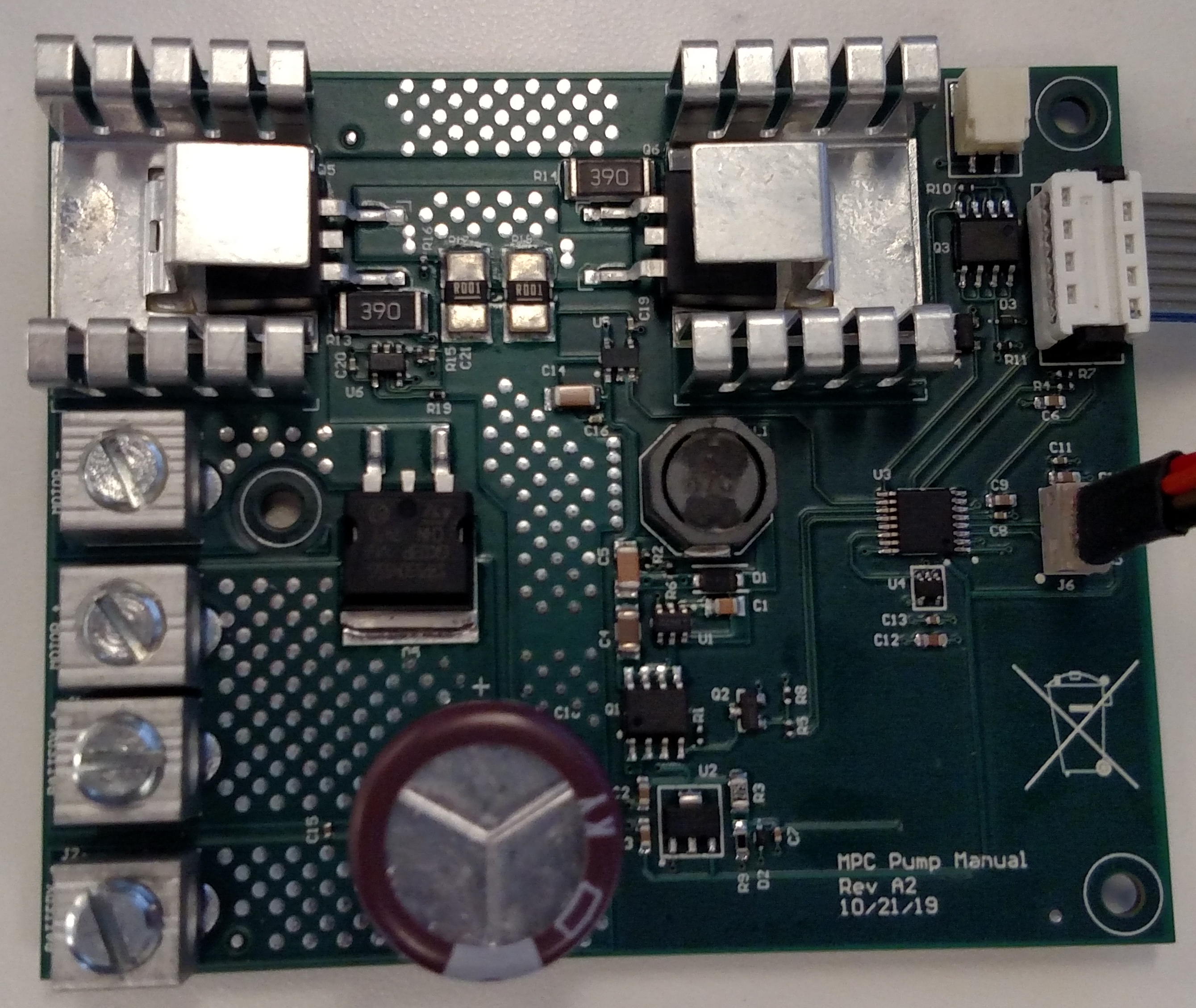

    I to am using the CSD19536KTT MOSFET, and have questions about the thermal impedance.  I have two of the MOSFETs on a board, top layer and bottom layers are 4 oz copper areas of 575mm2 for a total of 1150mm2 area with 4 oz copper (for each FET).  I also have 2 inner layers of 1 oz copper of the same area to give me a total 1 oz area of 1150mm2 (for each FET).  Also have heatsinks on top side on both MOSFETs (see attached photo).  Trying to determine how much continuous current I can pump through the FETs before the junction temperature is an issue.  In your previous response to John Wallace you gave a number of 30C/W for junction to case to the top of the package, would this be a good number to use.  I can measure the top case temperature and trying to determine what junction to case (top of case) number to use to determine junction temperature.  Any other suggestions on how I can determine this would be appreciated.
    Larry A. Gunseor
  • Hi Larry,
    Thanks for your interest in TI FETs. TI has modeled some of our FET packages including the CSD19536KTT in D2PAK. From these simulations, we have determined that RthetaJC(top) is ~30degC/W. I suppose if you measure the temperature on top of the case, you could back calculate to determine the junction temperature. However, not all of the heat is going to be dissipated thru the top of the case. In fact, looking at your board, it appears that the predominant thermal path is thru the tab of the device into the PCB and to ambient thru the heatsink mounted on top of the board. You can probably model this using Flo-Therm or Icepak. Of course, you can test it as well. In order to calculate the maximum current you can put thru the FETs, we would have to determine the effective RthetaJA. Again, this can be done empirically. Below are links to some useful blogs and a thermal application note. The first one is on thermal impedance and the second is on maximum continuous current. The app note is pretty self-explanatory. Please contact me if you have additional questions or need more information.
