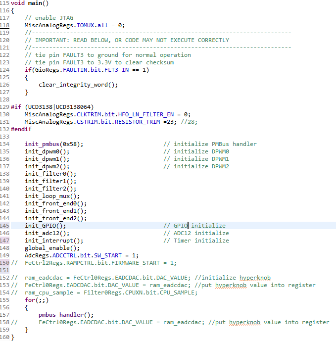

Have a problem with PMBus connection. When I download the firmware the programm on the board works correct without any errors but I haven't PMBus communication. The functional code I wrote myself. This is not the first code for the UCD3138 for our topology but I never have this problem before. I nothing changed in system files. Tell me please where could be wrong. All another our projects as well as codes from TI work correct on the same develop board.

    As the first step, please disable your interrupts and see if PMBus communication works.
    As if the interrupts getting invoked too often, or you do not clear the interrupt flag at the end of the ISR, PMBus(Or any thing else called from main) will not work.
    Also check that you do not configure any of the PMBus pins as GPIO, via GLBIO, or reroute the PMBus signals through IOMUX.
    Hope this helps.
  • Dear Yitzhak,
    without interrupt the PMBus comunication is ok. I will check the code in  the interrupt routines. Thank you

  • Dear Yitzhak,
    I thought that problem was in this function. Is it could be? I checked the interrupts and didn't found some problems there.

  • Dear Yitzhak,
    Problem was very simple as you said. One of the Interrupt routines. Thank you very much!
    I recreate my project and now it works correct.
