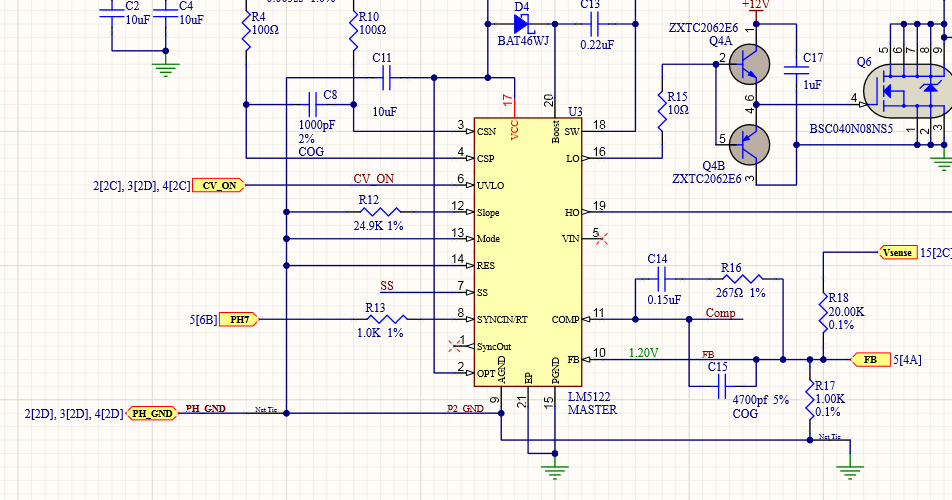

  • I will attach 3, 780-116533F 27V Converter.pdf
    780-115696B 54V Converter.pdf
    143309A 36V Reworked Converter.pdf
    The first two work, the last is the one I'm having issues with.
  • Hi William,
    It sounds like this might just be related to the control loop compensation.
    First please set the current sense filter back to normal, IE a non 30kOhm value. Then please try the following (I am refering to 143309A_36V_Reworked_Converter.pdf
    1. Change R17 to 900 Ohm
      1. This will set the output to 45V
    2. Loop compensation
      1. Change the following values to improve the phase and gain margin
                                                                   i.      R16 = 680 Ohm
                                                                 ii.      C14 = 100nF
                                                                iii.      C15 = 3.3nF
    1. Output Capacitors
      1. Make sure that these are 100V rated.
    2. Ceramic capacitors loss effective capacitance when a DC voltage is applied. This can reduce the capacitance as much as 80% for some ceramic
    Please let me know if you have any questions.
    Garrett

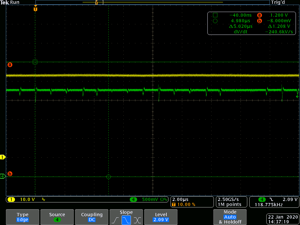

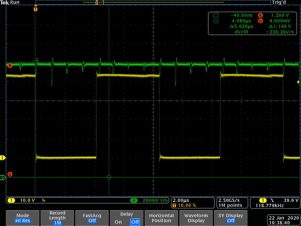

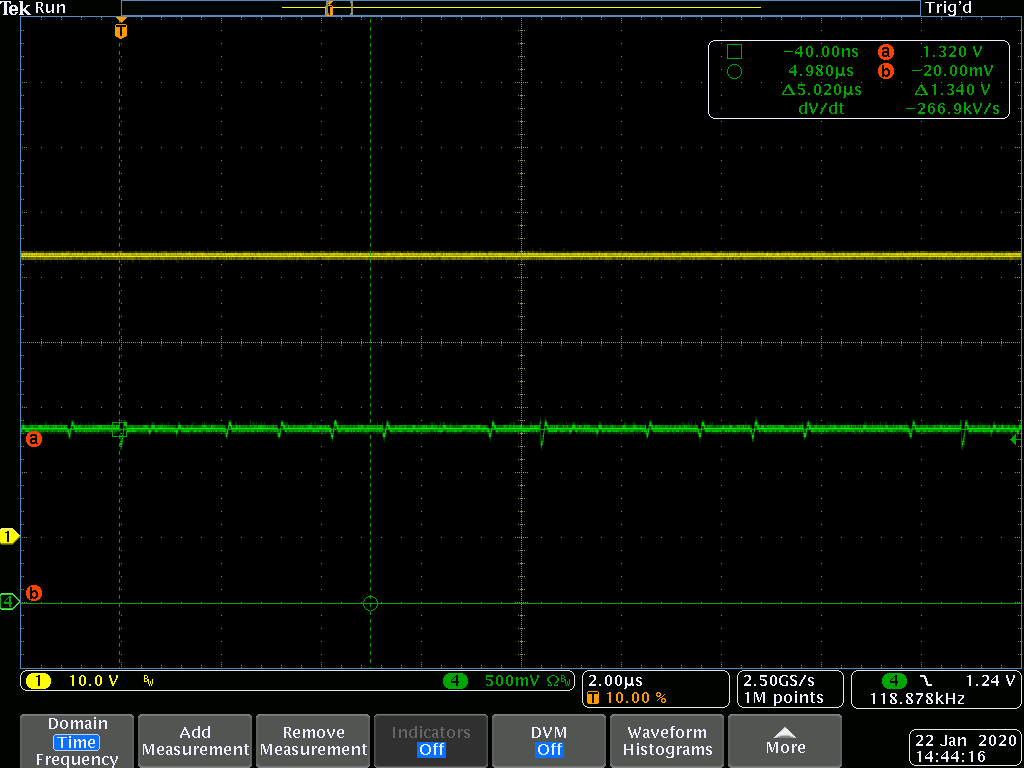

    Also can you probe the FB pin voltage and the COMP pin voltage? This will let me know if the converter is regulating. Please post a screen capture of the output voltage. I want to see if the output voltage is oscillating at all.

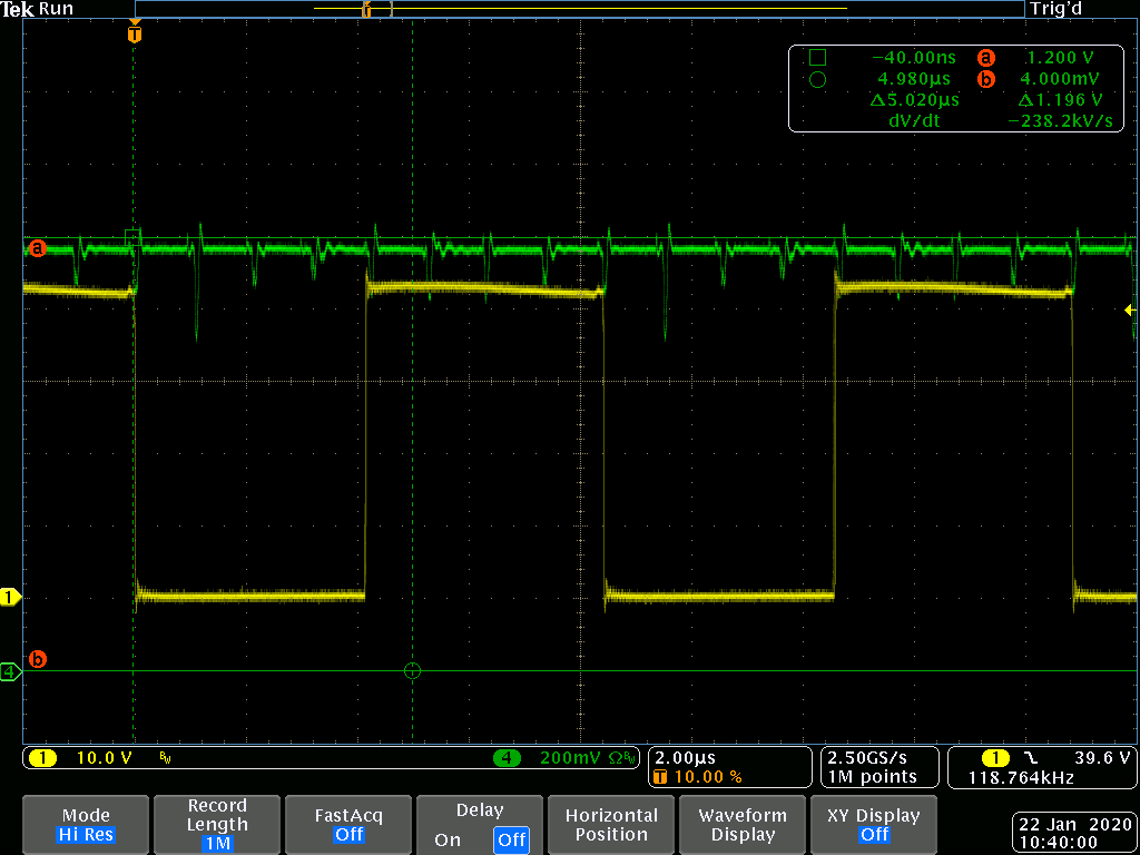

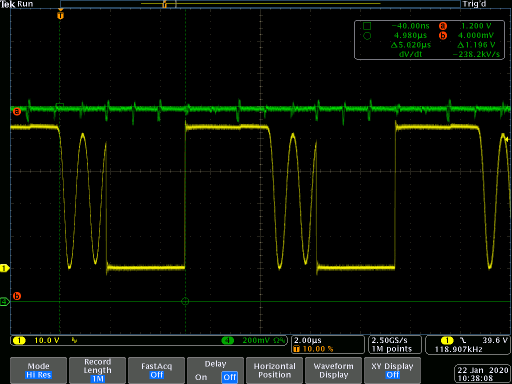

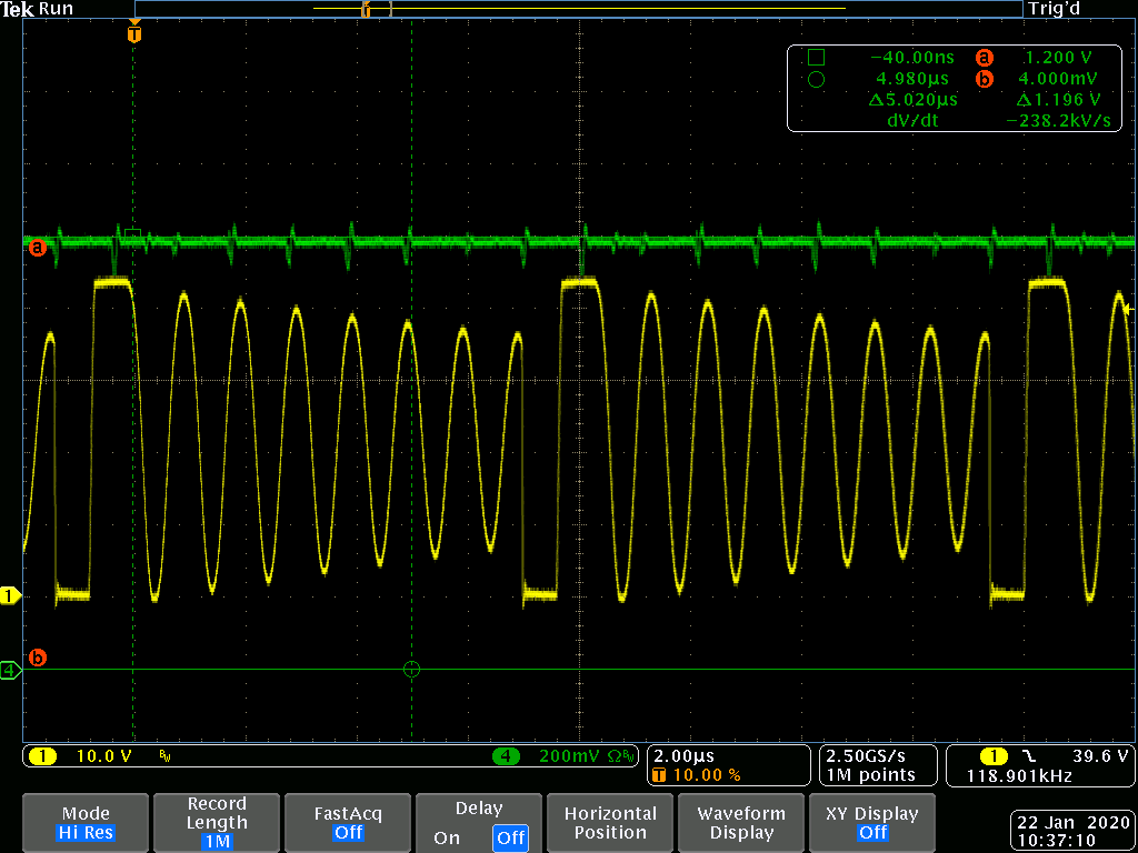

  • Garrett,

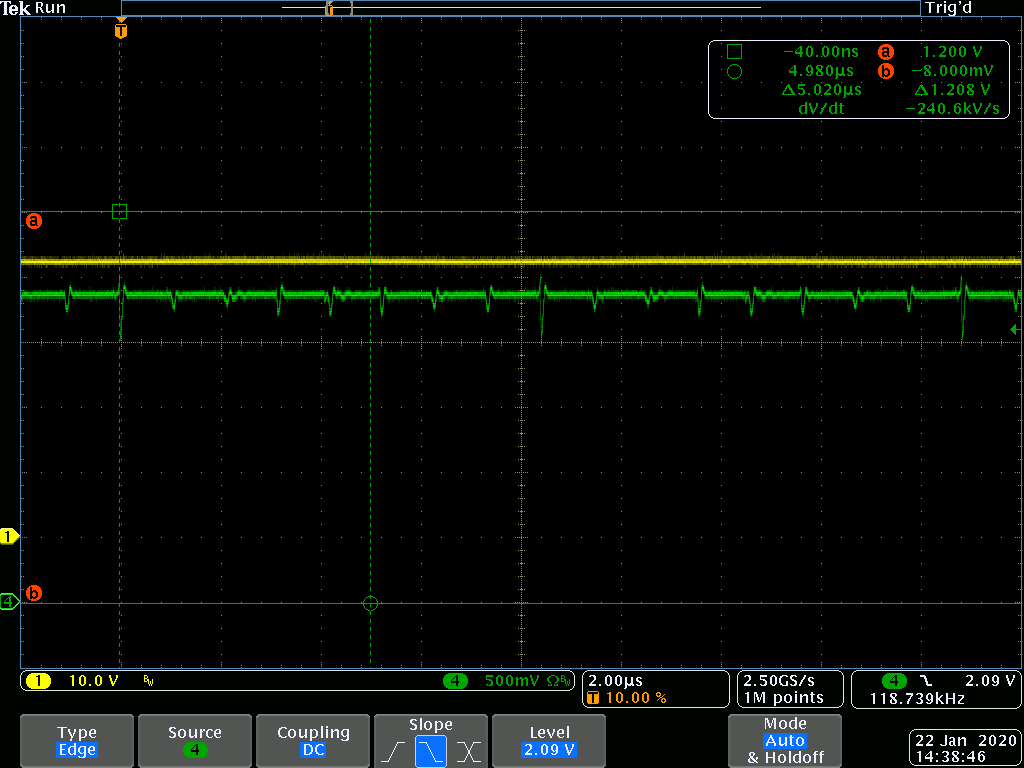

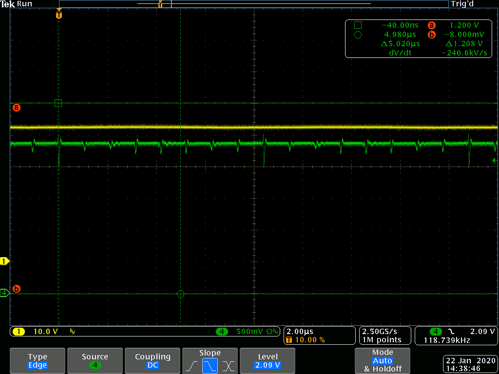

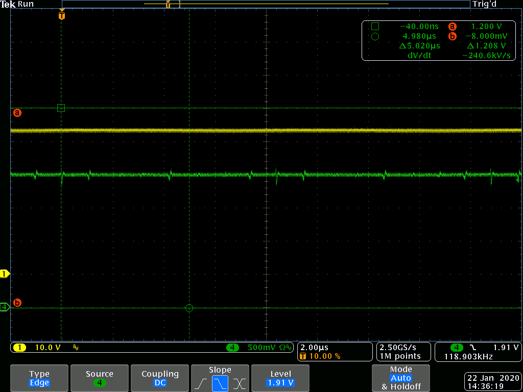

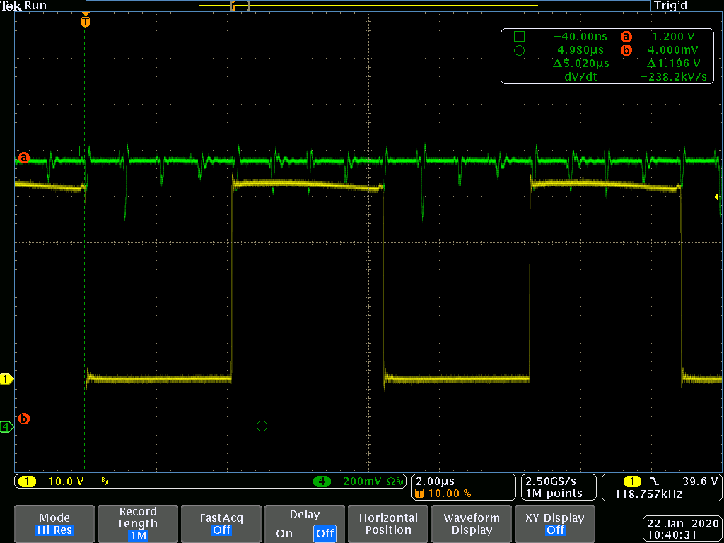

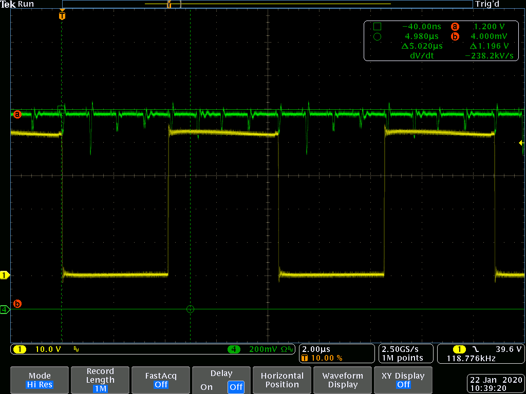

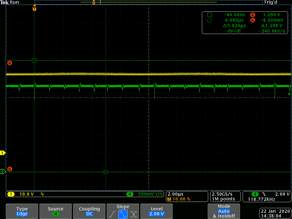

    40 X 10uF, 63V (now) MLCC, 5/phase, see schematic.

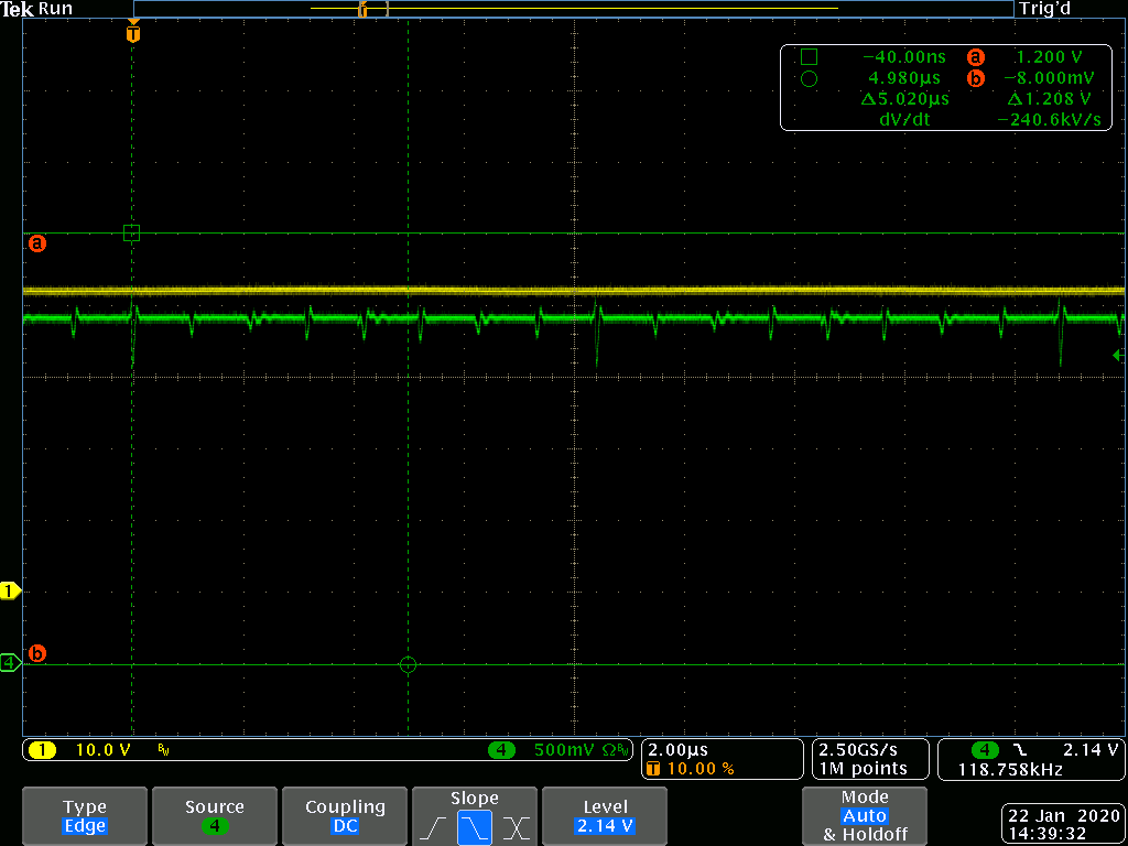

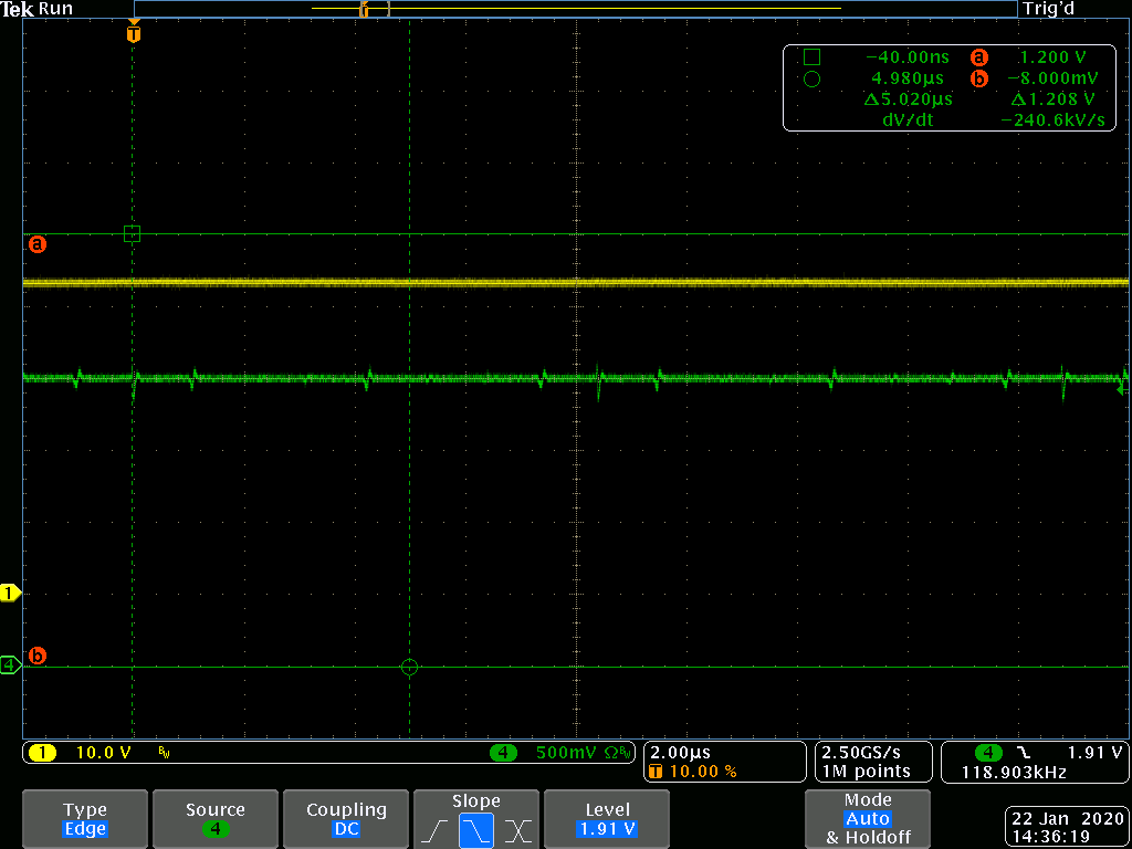

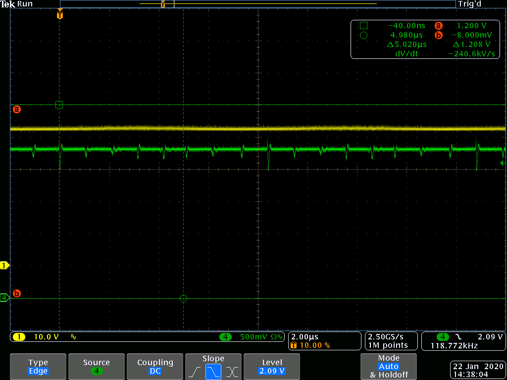

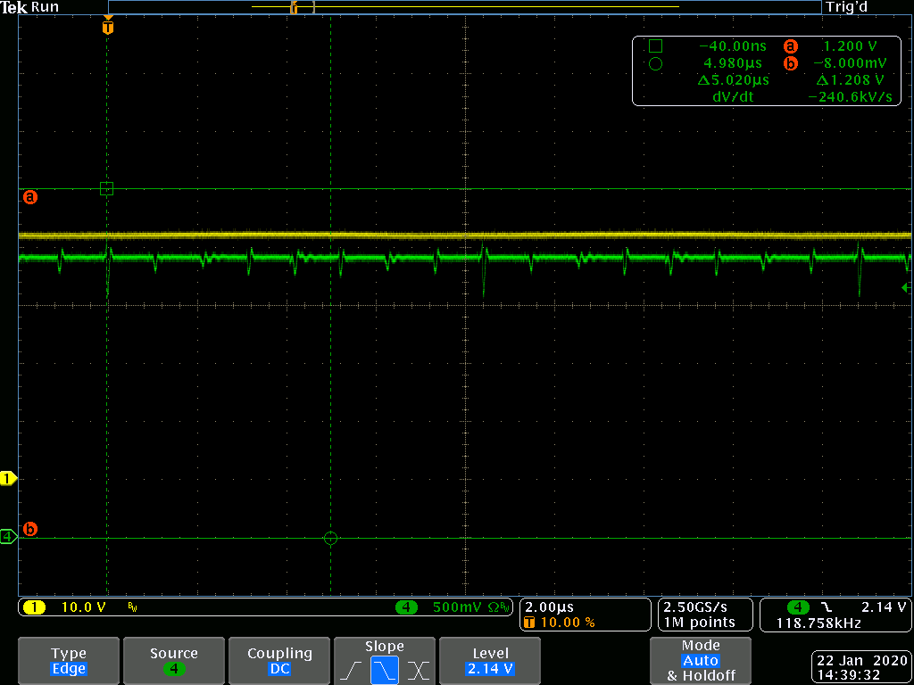

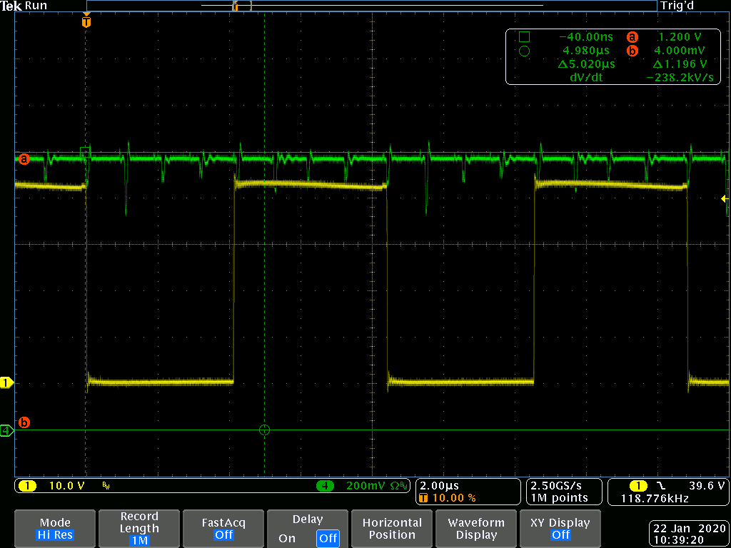

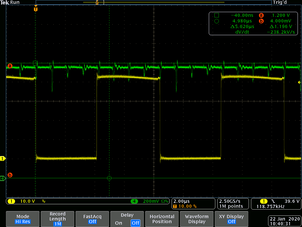

    Waveforms requested;
    File
    Output Current (Amps)
    Ref. Designator
    tek0008
    0
    R17
    tek0009
    10
    R17
    tek0010
    20
    R17
    tek0011
    30
    R17
    tek0012
    40
    R17
    tek0013
    50
    R17
    Note green cursors @ 0V and 1.20V (chip reference). Yellow trace is across boost fet phase 1.

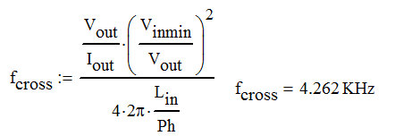

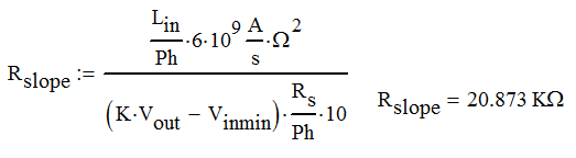

  • I discovered the note of table 2. I notice the phase number, or "n", cancels out if you plug the equation:
    into;
    They also cancel out in the Rslope equation;
    What about the Rslope minimum equation? Neither the inductor nor the sense resistor appear.

  • Hi William,
    The slope resistor doesn't need to change with the number of phases. The slope compensation is needed on each phase . Note the slope compensation is related to the falling slope of the inductor current and the sensed current for each phase.
