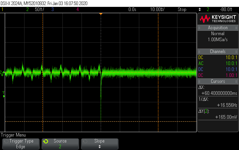

I am getting a transient dip of 165mV (5V to 4.835V) during the load change from 15mA to 250mA.
I am using L=100uH,DCR=280mOhm and Cout=100uF,ESR =125mohm , Cin=47uF,ESR =125mOhm
What can be the reason for this high voltage dip during the transient?
How we can improve this response?
