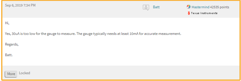

 https://e2e.ti.com/support/power-management/f/196/t/837077 In this URL, TI engineer said, the measured current need at least 10mA.

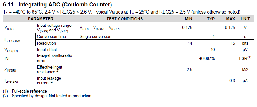

    VsenseR is from –0.125 V to 0.125 V.  I choose senseR=0,1Ω, the same as BQ35100_EVM demo board.
    In our product, the Peak load current is about 600mA. And the load current is down to 20uA when the whole system is in sleep mode. In most of time, the current maybe 5mA, 10mA or 47mA.
    We will only use ACC mode in our product. I can't find the accuracy of BQ35100 in the spec. So what is BQ35100's accuracy in ACC mode, when the current is 600mA, 47mA, 10mA, 5mA and
    20uA? Do TI have a typical value about the charge accumulation accuracy?
  • This is not something i can spec because it depends on external components. I can provide hardware accuracy which can be found below. I would suggest you run a test after your calibration routing where you apply these specific currents for 1Hour and verify the charge accumulated.

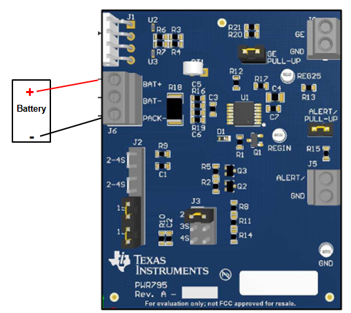

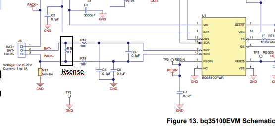

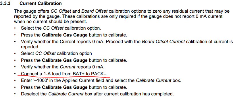

  • Hi Eric,
    When calibrating 1A, we "Connect a 1-A load from BAT+ to PACK–." But the spec hasn't said how to connect when doing cc offset and board offset calibration.
    When doing cc offset and board offset calibration. We should confirm the current flow to Rsense is 0A.
    As we known, the current consume of BQ35100 will flow pass Rsensor, which make the current is not 0A.
    Can I connect the battery's + to BAT+ and battery's - to Pack-(the GND of BQ35100) like the second picture?  By reading the schematic of BQ35100_EVM(the third picture). I think in this condition, the current flow pass the Rsense will be 0A. Is it right?
    This is a low side sense resistor. As long as you have current flowing through the sense resistor between Pack- and Bat -, that is fine. BAT+ and PACK+ in this case is the same bus.
  • Depending on the size of the senseR this might be an issue. I do not think it will be one in the grand scheme. What you could do it apply a hard short directly across the SRN/SRP pins to force the gauge to think there is 0 current.
