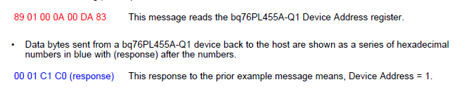

I am trying to operate BQ76PL455EVM with F28379d Launch Pad on Matlab. I started with "bq76PL455A-Q1 Software Design Reference".

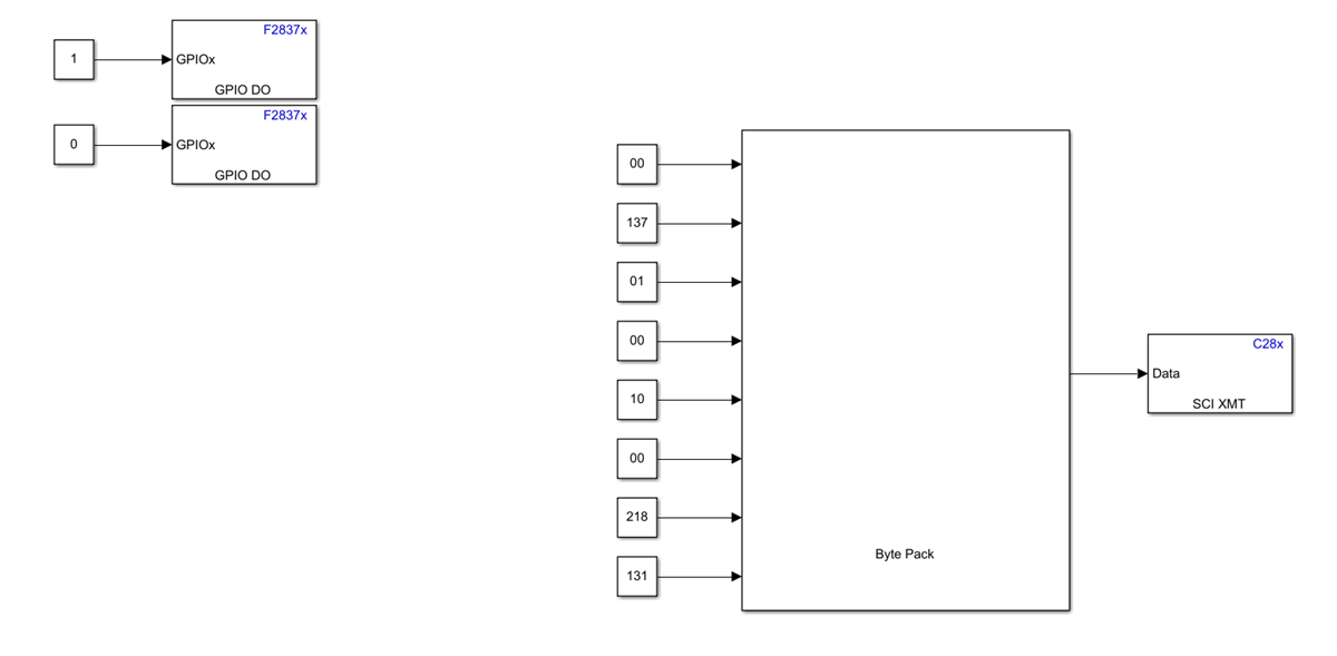

On Matlab Model I pulled output of WAKE to HIGH and FAULT to Low.
Then I have sent "008901000A00DA83" from SCI. But can not receive any signal from TX port of BQ76PL455EVM.
What may be the problem. How we can solve it?
