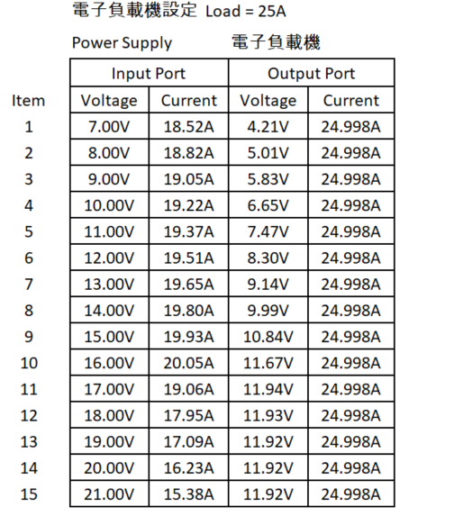

[Condition 1]
   When the output 10A input voltage gradually drops to 11.9V  The output voltage 12V becomes 0V, DC-DC Turn OFF
   When the output 10A input voltage gradually rises to 12.1V  The output voltage 12V becomes 12V, 10A DC-DC Turn ON
   [Condition 2]
   When the output 25A input voltage gradually drops to 16.9V  12V output voltage becomes 0V, DC-DC Turn OFF
   When the output 25A input voltage gradually rises to 17.1V  The output voltage 12V becomes 12V, 25A DC-DC Turn ON
Do customer need SS, COMP, SLOPE to modify the settings?
Can you guide us how to modify the setting output to 12V / 25A?

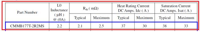

  • Hi Youhao,
    Would you help check if this inductor ok for this case ?
  • Hi PY,
    I ran the LM5176 design calculator, and found the peak inductor current can be 48A (typical) owing to the 2.5mOhm sense resistor, which exceeds the inductor's 33A rating.  The TI reference design chose an inductor of Isat=51A, so it worked.  Please change to an inductor of higher rating.

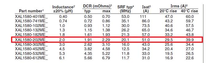

  • Hi Youhao,
    We tested again using the same inductor as that was used in this reference design PMP21278
    XAL1580-202ME spec as below
    Below is our test result, at 25A the circuit still not work correctly, however if load is 1A it work OK.
    May we have your further suggestion ?
  • Hi PY,
    It is obvious that your circuit hit the peak current limit. Did you really use 2.5mOhm (two 2.5mOhm in parallel)? Did you use the same type of resistor as used in the PMP design?
    I am afraid your sense resistor may have larger parasitic inductance that causes the sensed signal greater than actual value, owing to the amount of Lr * di/dt superimposed on to the i * Rsn, where Lr is the sense resistor parasitic inductance, and di/dt is the power inductor current slope?  Can you increase C15 to 2.2nF and re-do the test, and let me know any improvements?
    Youhao
  • Hi Youhao,
    Yes, you are right. The problem is on the current limit circuit. if we short directly the current sense resistor. the circuit can work correctly. it can output 25A no problem.
    However If keep the current sense resistor and increase C15 to 2.2nF, we can only get 7A output. (only 1 A increase) .
    We will check the current sense resistor's actual value.
    Any other idea (besides the current sense resistor value not correct ) that might cause this symptom ?
    Thanks!
