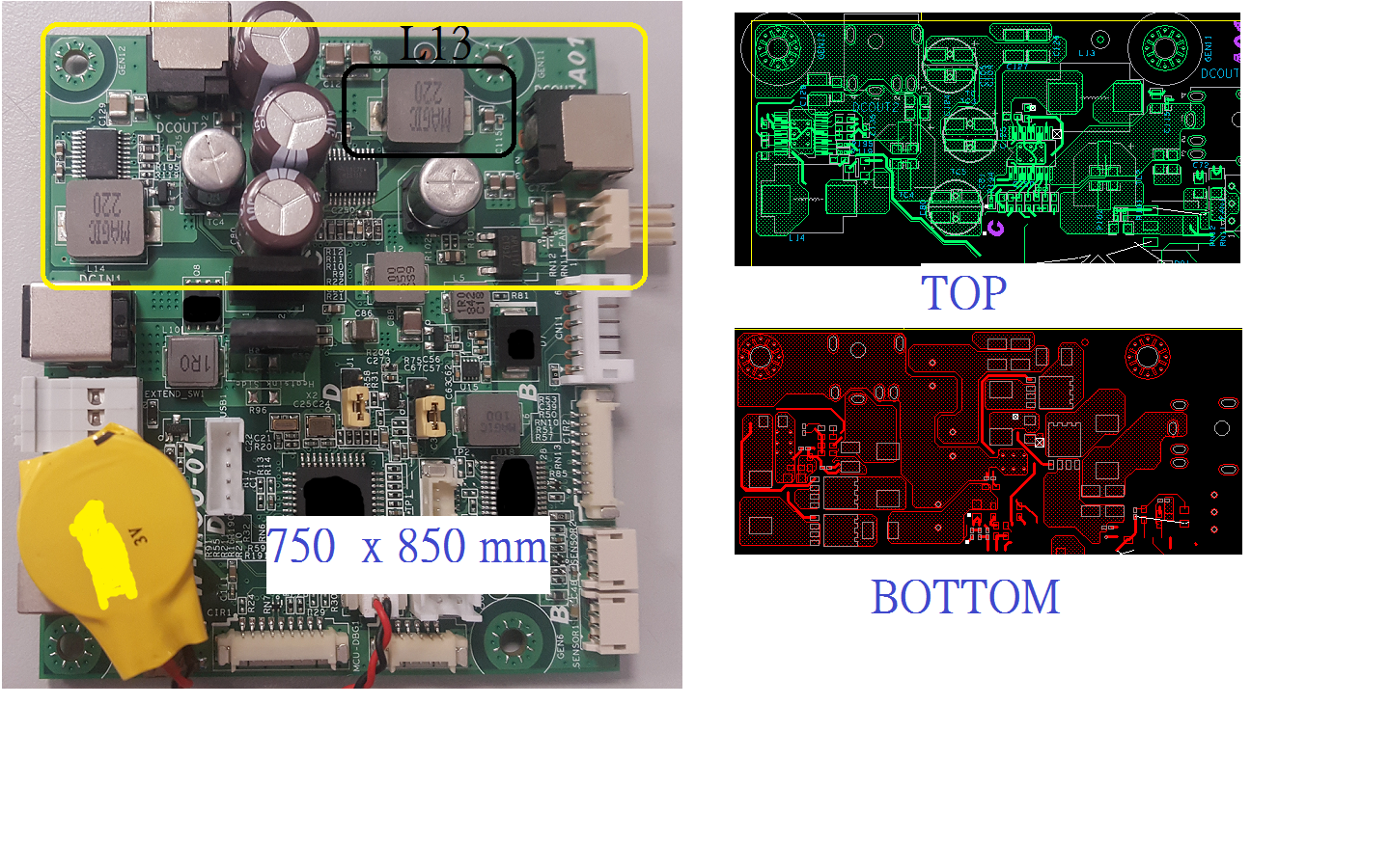

  • Hi Su Roger,
    The 6.8uH inductor is only rated for a saturation current of 16.5A. Worst case for your design the inductor current can be higher than this  I recommend charging to an inductor with a saturation current greater than 22A. Based on the current levels you are using now it seems there is not a lot of copper to sink the heat from the inductor. Can you send me a picture of the board?
    Can you please send me copy of the schematic with the capacitor values? There are some values that I want to check but the part numbers are not showing up online.
    Garrett
  • Hi Garrett Roecker:
    ok,I will try to use 6.8uH, Isat=38A on next version;Now I have no sample to test
    below is the  information related to the board:
    And please reference to the attached Excel file, You can find the value by component location,LM25118 capacitor spec.xls
    Thanks!!
  • Hi Su,
    Thank you for the pictures but we cannot easily locate the parts or trace the signals.  Anyway, please change the inductor as Garrett recommended, and let us know if you see improvements.
