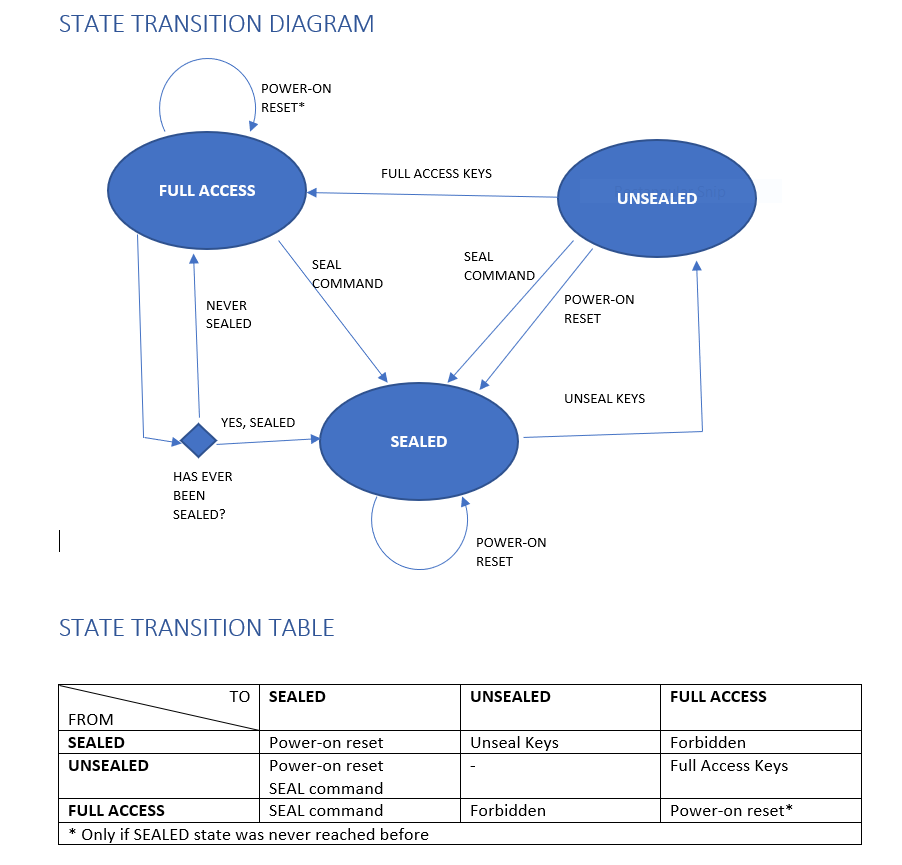

I am experiencing the very same problem:
I power the BQ35100 and read the Control Status, I get 0x2080.
Initialisation in complete so I send 00.14.04, and after 20 ms I send 00.72.36.
After 20 ms more, I ask for the Control Status and get 0x2080, again.
I2C bus clock frequency is 100 kHz.
I checked the communication with the scope and I saw nothing abnormal. Ack, Start, Restart and Stop are where they are expected to be.
What am I missing?

  • Fulvio,
    The 0x0414 and 0x3672 need to be complete independent writes. If you are not issues a stop signal it will not work.
    I suggest using bqStudio and clicking the 'unseal" button on the right and scope capture it to compare against what your system is sending.

  • Should I switch to SEALED mode first?
    I.e. FULL ACCESS --> SEALED --> UNSEALED
    Kind regards,
    Fulvio
  • Yes, sealed.
    Then go unseal and then full access.
    I have the same issue of yours.
    I'm in SEALED mode (control status = 0x6080) so I send the unseal keys (0x1404 and 0x7236) but nothing happens. I think this is a timing issue, indeed in debbugging mode it works perfectly. I tried many delay between the two writes but I'm still stuck here.

  • Hi Vincenzo,
    in my case it was just that the allowed state transitions are not documented anywhere, so I had to discover it by myself that I had to move from FULL ACCESS to SEALED before to get into USEALED.
    I used just 20 milliseconds delay between the two keys and it worked.
    Fulvio

  • Both,
    When the gauge receives an Unseal or Full Access attempt it will force a 4 second lockout. Sending the Seal command does not trigger the lockout.
    In addition, the gauge must be sealed to go to unsealed and unsealed to go to full access.
    Eric Vos

  • Hi Fulvio,
    I tried several timing between this "access" operation over DataFlash. Now, I have this behaviour:
    • UNSEALED
      • write(0x00,0x14,0x04)
      • WAIT 1 SECOND
      • write(0x00,0x72,0x36)
      • WAIT4 SECONDS for LOCKOUT as  said
    • FULL ACCESS
      • write(0x00,0xFF,0xFF)
      • WAIT 1 SECOND
      • WAIT4 SECONDS for LOCKOUT as Eric said
    After each operation I found 0x4080 and 0x2080, respectively.
    So, for me it works GOOD
    I also tried to remove the 1 SECOND delay between the two unseal key writes without success.
    Vincenzo.
