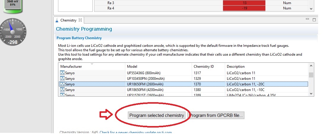

Hi
Before I start the learning cycle, am I right to say that I need to go to the Chemistry Programming window and select the Chemistry ID and click "Program selected chemistry from database" such that the Ra Tables and Chem ID will be updated accordingly?
