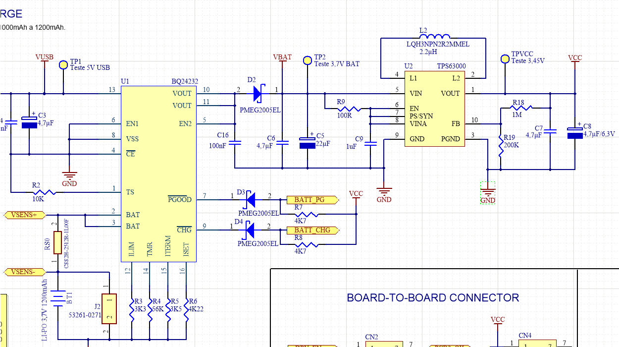

We are using the TPS63000 to regulate the circuit supply voltage around 3.45V as shown in the image below:

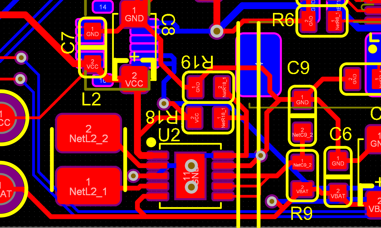

PCB layout:

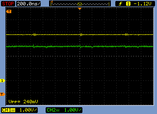

The output voltage is stable at 3.58V for input voltage from 2.0V to 2.9V. When the input voltage exceeds this range, the output voltage starts to rise and the TPS heats up even more.
INPUT=GREEN(2,8V) OUTPUT=YELLOW(3,6V)

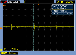

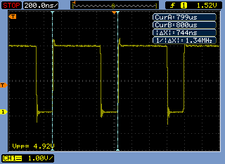

INDUCTOR FREQUENCY.
INPUT RIPPLE DUE TO TPS63000 CYCLE.

    Looking at your schematic your choice of caps is not optimal.
    According to the application guidelines here , please consider the following changes:
    C6: increase to min 10uF ceramic (you can keep the electrolyte C5)
    C9: reduce to 0.1uF, this is a filter cap
    C7: increase to 10uF ceramic
    C8: exchange with ceramic and increase to 10uF
    this is necessary for the basic stability.
    In your layout I see a couple of items, which are not optimal, please see here for recommendations
    - Your GND connection doesn't have a plain
    - Both input and output caps are too far away from the device. This can cause instability.
    In scope plot 2 (Inductor frequency), can you please let me know, which pin you measured, L1 or L2.
