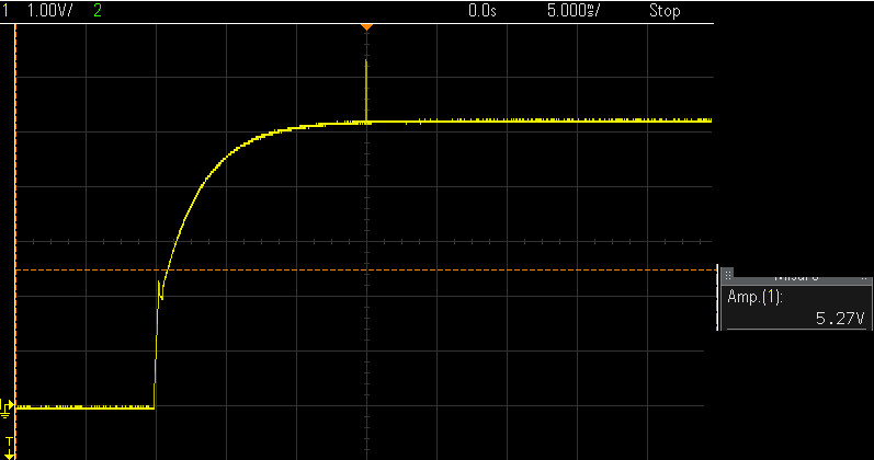

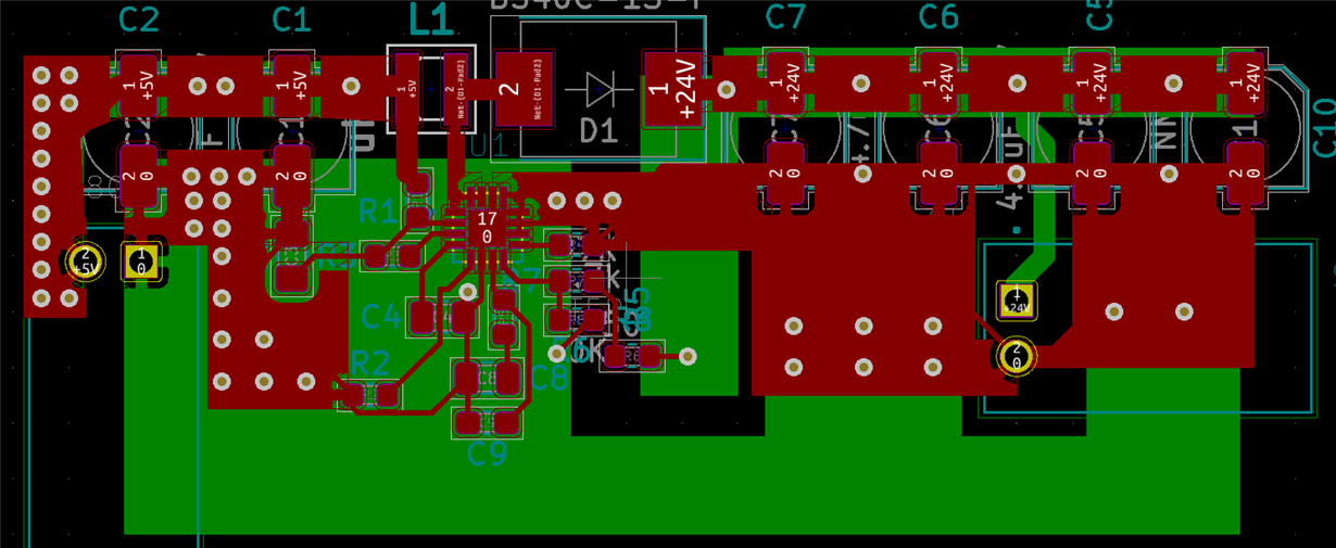

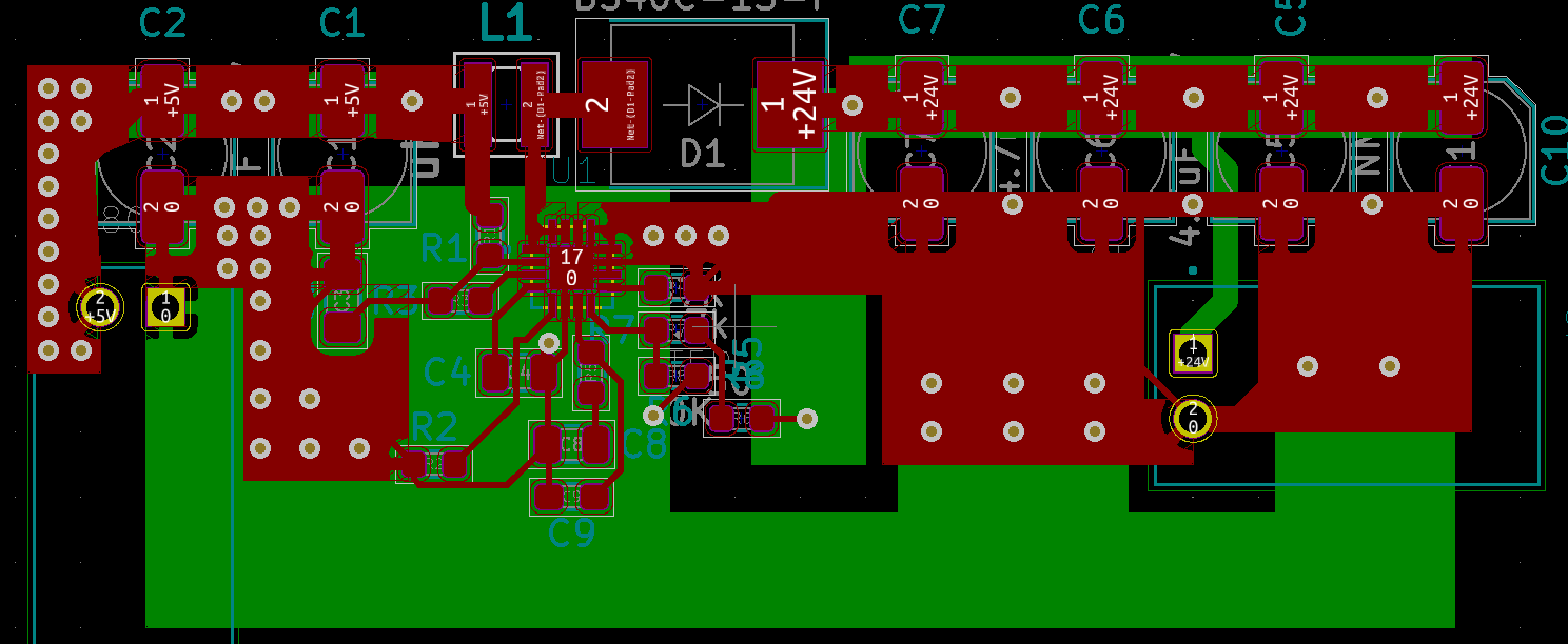

After much time i tryìied to solve that problem:
I made a new pcb but it doesn't work.
Really i don't understand

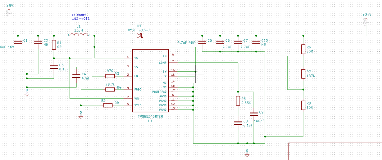

Hi andrea,
Thanks for using TPS55340.
Could you share your new PCB so that I can help check it?

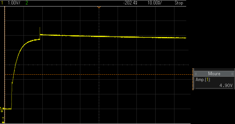

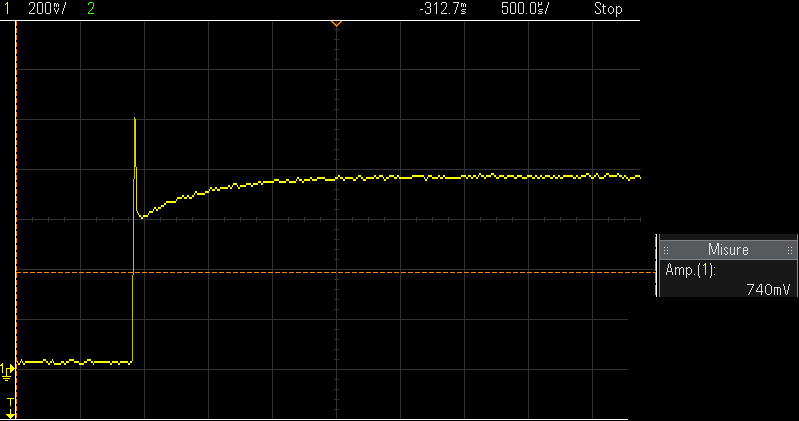

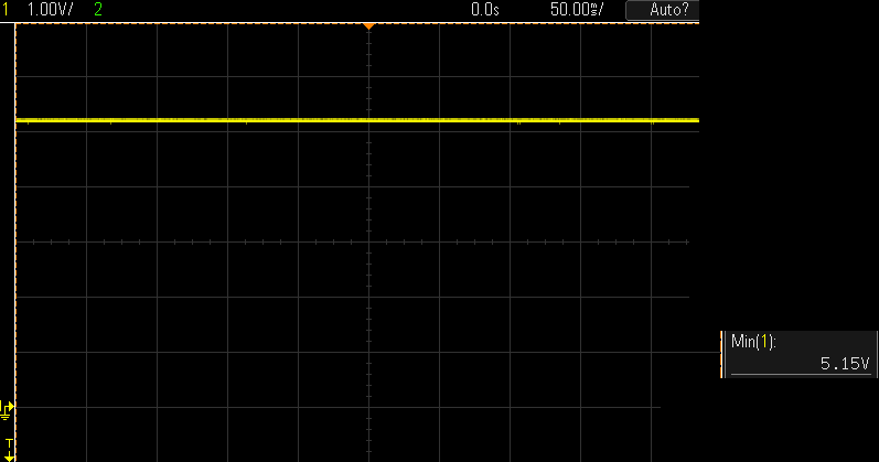

Hi Andrea,
Could you check and make sure that the VIN, EN, FREQ, SS, and SYNC pin voltage are at the correct level?
After that, could you probe COMP, FB, and SW during the startup?
Yinsong

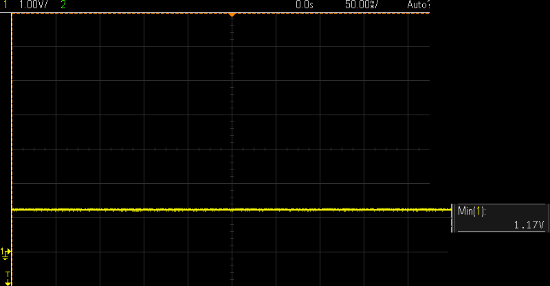

Hi Andrea,
Could you double check the FB voltage? If it goes to 5V, it is wrong and is already higher than the maximum rating which is 3V.
