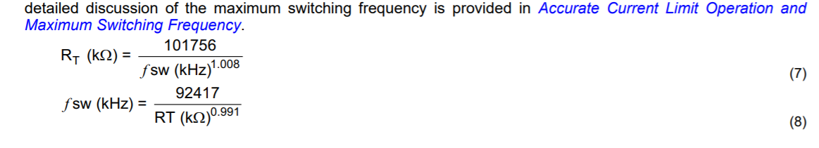

I would like to know calculation forum as fsw(kHz) = ..?
Datasheet shows below
TPS54360B datasheet show as below:
Could you please let me know " fsw(kHz) = " of TPS54260?

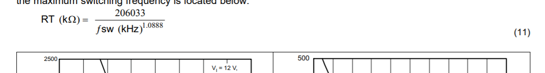

pls follow TPS54260's datasheet its Rt caculation.
Hi
what means FAE analysis? do you mean below equation?
fsw(kHz) =75953/Rt^0.918.
