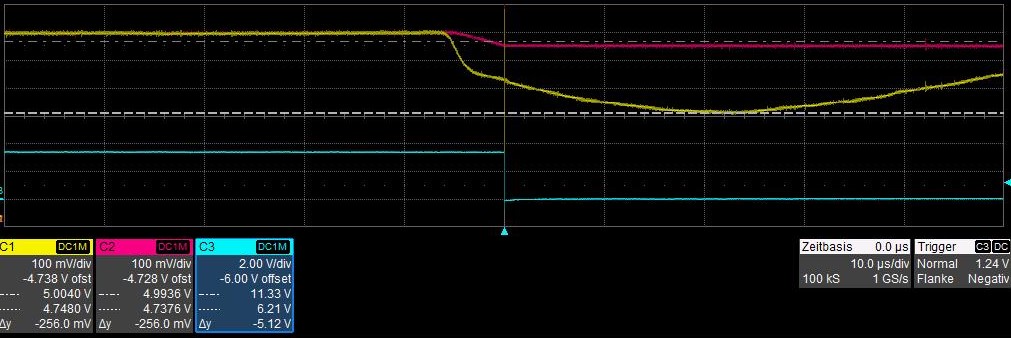

In the scope trace you can see how the output voltage (red trace) follows the input voltage (yellow trace) until the error output is set (blue trace).

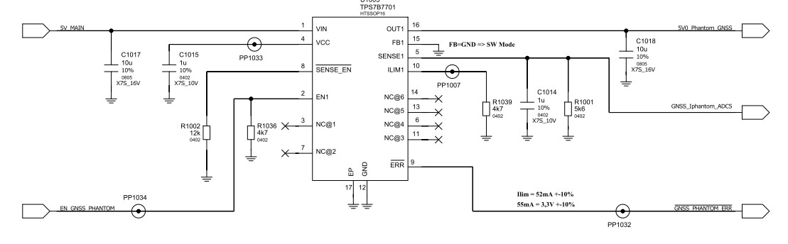

Our Implementation is as follows:
We also found that removing C1018 solves the issue and the output voltage immediately follows the input. In the thread mentioned above, its not finally clear if the capacitor is required. Is it possible to use a much smaller value (e.g. 100nF) if using the device in Switch mode to maintain full functionality of the IC? Or are 2,2µF the lower limit for the output capacitor?
Do you have any suggestion how to solve the issue without Diodes?

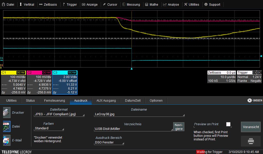

  • I tested with replacing C1018 with 2,2uF at the output. This improves the behaviour and the chip seems not to enter reverse current protection State, but the effect that the input voltage drops below the output voltage is still present. Below are three captures with 0, 2,2 and 10uF at the output.
    How can I be sure that with 2,2uF the chip will not enter reverse current protection under all conditions? Maybe I'm close to the limit and getting a bord with higher tolerance witll enter the error state, even with 2.2uF. Can you please provide how to validate that the reduction to 2,2 uF at the output is a sufficient measure?
    I always tried to increase the input capacity, but I found that the effect is only minmal when doubling to 20uF. to get a significant effect, I think I need to increase to a much larger capacitance which is not practicable in our desing.

    thank you for the reply. The input of the TPS is driven by a 5V DC switching regulator.
    The voltage drop is not caused as result of a switch off event.
    There are several other sinks on this supply and one has high load current transients (>= 1A). These transients cause the voltage drop. The drop was measured at the TPS input and is the combination of the regulator load transient response and the lossed caused by the PCB trace impedances....
    Unfortunately the drop is caused multiple times each second when the system is running and after a certain while (about 1-2min.) the TPS goes into the error state.
    Michael

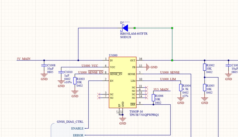

    Thanks for sharing the information about  your application. Do you think you could try to have a schottky diode between the output pin and the input pin and run some tests? The diode need to have a lower turn-on voltage and this will help discharging the output and charging it back to the input to reduce the chance for a RC detection by the internal circuitry.
    Jason Song
  • Hello Jason,
    you mean that the ouput capacitor can be discharged via the diode? In this case, the reverse current blocking of the IC would not work because the reverse current will
    conduct over the diode path, or am I wrong in my understanding?
    I understood you request like this:
    best regards,
    Michael Möller
  • Hi Michael,
    Yes, if you have the diode as shown in the schematic, the external diode will discharge the output to Vin to prevent the device from triggering its internal RC protection that will latch the output. As we discussed, there is little thing you could do to slow down your input droop and a 2.2uF is required for the stability of the LDO.
    Will this meet your needs?
    Jason Song
