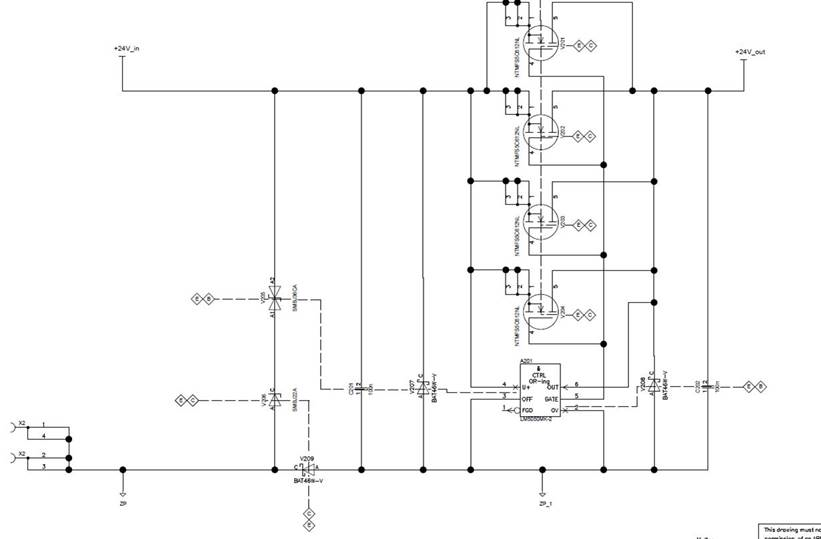

My customer use LM5050-2 in our product. The related schematic information is as follows:
Between +24V_in and ZP, there can be -35V applied. In this case, diode V209, is used to protect A201(LM5050-2). And at the same time we also use diode V207 and V208 to make sure the voltage between U+ and 0V, between OUT and 0V of LM5050-2 do not exceed -0.3V, which is stated in the datasheet of LM5050-2.
The point now is, Can we remove V207 and V208, and only rely on V209 to protect LM5050-2 under reverse polarity case(between +24V_in and ZP)?
We can make sure that under worst case the reverse leakage current of V209 is less than 100uA.
Can we say under this reverse current LM5050-2 is safe without additional protection of V207 and V208. Removing V207 and V208 is now critical to our design due to limited PCB space.
HI
Yes, V207 and V208 may not be needed for -03V but would be required for transient protection on positive side.
Let me confirm this soon today.
Kari.
Hi Kari:
Why? The device could support 100V transient voltage , and the Vrms volatge is only 24V . i think it could remove the diodes becasue there is impossible voltage which could exceed the 100V.
