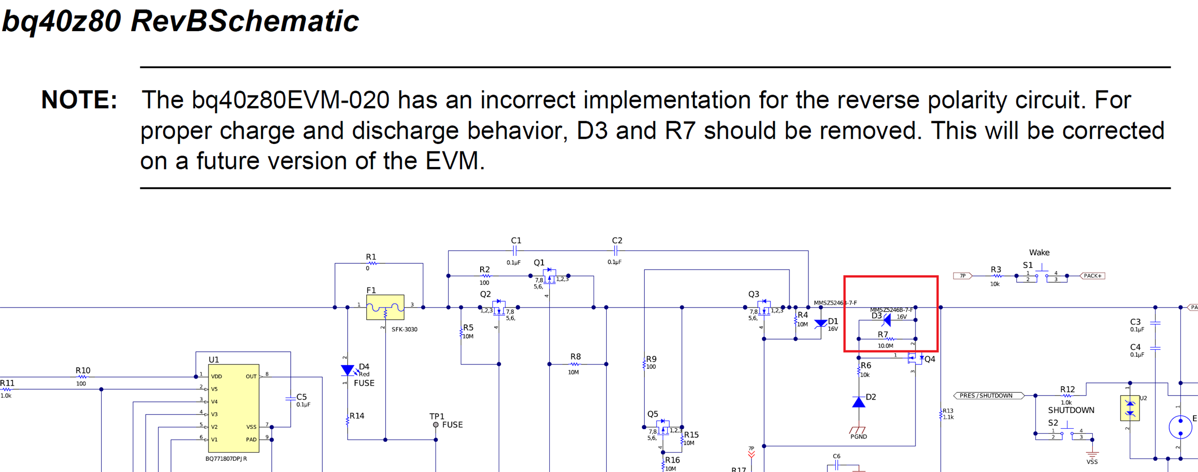

on the  EVM manual of the BQ40Z80  there is a note:
Can you provide the schematic with the correct implementation for this protection?
I need to draw my schematics including this part that works.
