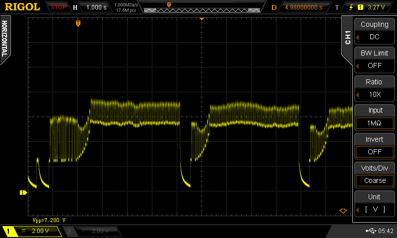

We are trying to use a smaller 15mm coil (Abracon AWCCA-15N15H06-C01-B and Wurth 760308101219) and we are having issues getting the BQ51003EVM to respond when we modified.  We are using an off-the-shelf Anker TX coil (https://amzn.to/2TT4b3K) which works correctly when used with the EVM's reference RX coil (LED turns on for both TX and RX)
Attached are the calculated C1 and C2 values taking measurements as described in the BQ51003 specification for the Wurth RX coil.  They are very similar to those of the EVM.
When we bring the Wurth RX coil + EVM near the TX coil, the TX LED turns on for several seconds.  RECT voltage is sitting around 4.5-5.5V during this time.  However, the RX LED does not turn on.  I'm assuming there's a communications failure.
Does the BQ51003 have issues with smaller coils?  Should we get a smaller TX coil?  Is there a way to look at the communications?
